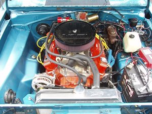

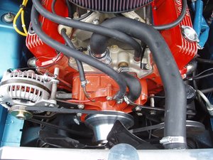

Here are some pictures of my 94 408 Magnum in my 69 Barracuda.
Edelbrock Magnum Airgap intake with 70 up water pump. I think I just used a 74 Duster by-pass hose. If it was not from a Duster, it was a stock mid 70's hose for a Mopar. I'm pretty sure this will work on a pre 70 water pump also, as that is what I had thought about using for a while.
Thanks
that helps a lot!
i assumed with all of the intakes that edelbrock has sold there must have been an easy solution (some people are just too anal i guess)
by the way what trans did you use?
thanks again
I'm using a TCI 904 with a Cheetah manual valve body and deep pan with a Cheetah 2900 stall (or there about), but if it goes I will be getting a better one, but still a 904. Maybe Coan or a Mancini.
As for the bypass hose, just make sure the intake side is big enough to go over whatever pipe is comming out.
