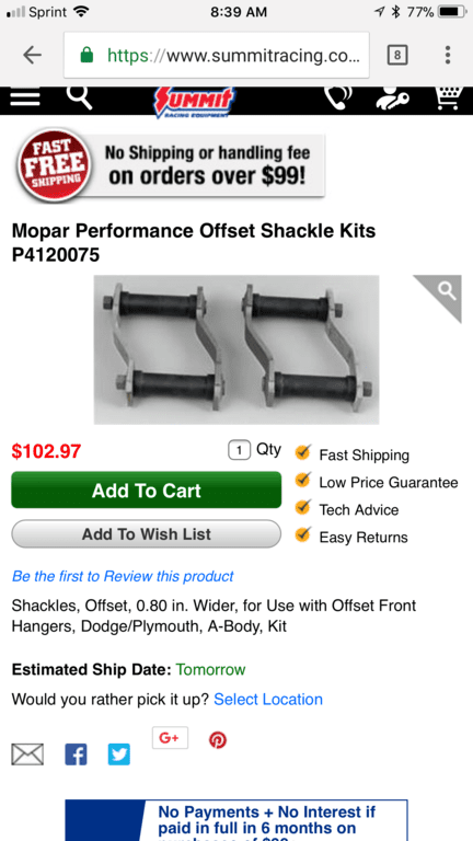

Summit racing sells the off set shackles and front spring hangers.
