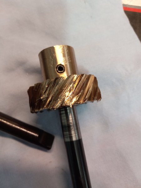

You can see the wear on the shaft in post #28. Less than 2000 miles on it!!!! This wear is what I was referring to in post #26.

The drive in post #28 has less than 2000 miles on it. Imagine what it would look like after 20,000 miles!

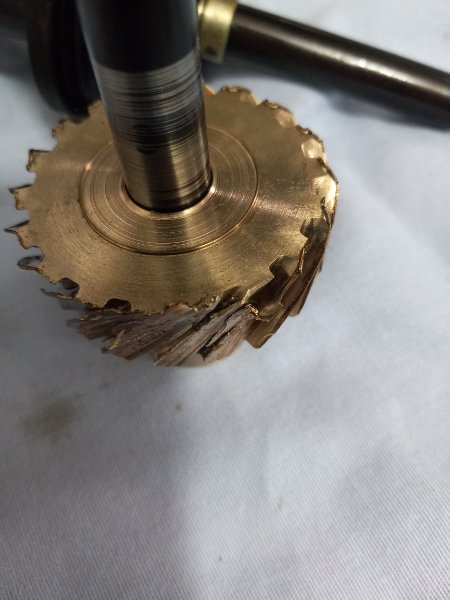

here's a couple shot of my gear I just pulled this morning. Don't mind the buggering up on the stem portion. That's from yanking it off the shaft.
6700 street miles and many passes, which was 4 summers for me. This summer was crap. Only did 1100 miles. excessive heat and rain.
Cam is Lunati solid roller .640/.640 259/265 @ 50.
I've often wondered if cryotreating them would help to any measurable degree, but then I switched to the melonized gear.
That's a Comp gear, by the way. Far as Cryo goes, I've had several competition rifle barrels done and the dude I deal with told me once that Cryo is "as effective as the hardness of the material being treated". So my guess is no good for bronze.
