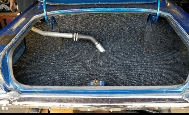

I found a spare from a Ford Edge. It is 4.5 bolt circle and the tire is 27 inches in diameter. It fit nicely in my B-body trunk well, I'm not sure about an A-body though. I did have to open up the center register a tad to fit over the axle stub.
I used a stock steel 14 x 4.5 steel wheel and a Coker Tire Firestone Radial F560 Tire 155R14
https://www.jegs.com/i/Coker-Tire/2...3t7lJdP_wYyqSzApDwPTzzOwLpi0cFlhoCxNkQAvD_BwE
Sits flush in the spare tire wheel well, and is sub 100.00.
