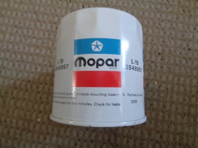

I found a guy that has some NOS Mopar oil filters for sale. I was just wondering how these would compare to a modern WIX filter? I like the looks of them but don't want to run one if they are inferior quality. Thanks in advance for you help!
Edit: I had to go back and edit this thread. I wasn't clear the first time. Would you run a 30-40 year old NOS filter on a high horsepower engine? Do you think that the filtering material could be compromised? Thanks

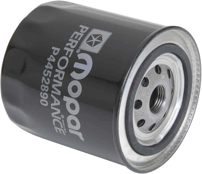

Here's what I use.
Mother Mopar approved with a Mopar part number.
Available at any Dodge dealership. (note I said Dodge LOL !! )

Back in the day, I would’ve had no problem running this filter. I guess what I’m concerned about is now that the filter and paper are 30 years old couldn’t it possibly have deteriorated? We’ve all picked up a old cardboard box that crumbles in your hands.
When I worked in the automotive trade back in the late 80s/early 90s those filters were all we used, no matter the make or model of vehicle, never had a problem with them.
No one has answered the OP's actual question. For what it's worth, I've been running NOS filters in my 56 Plymouth that are most likely more than 30-40 years old. Hasn't been a problem yet.
Not sure I would run such an old filter - even though new - in a more high performance motor.
Brian - I would NOT run that old of a filter. Filters typically have a sealer/glue in them be it on the end caps or the bypass or whatever. In my mind, that glue would deteriorate over time to where I wouldn't trust it. There are plenty of up-to-date filters you can go buy and run today. Why risk it as you have a gorgeous high-end car!

never happened, I have 2 test silk screened wix filters in mopar
also agree I would never run a 50 year old filter
