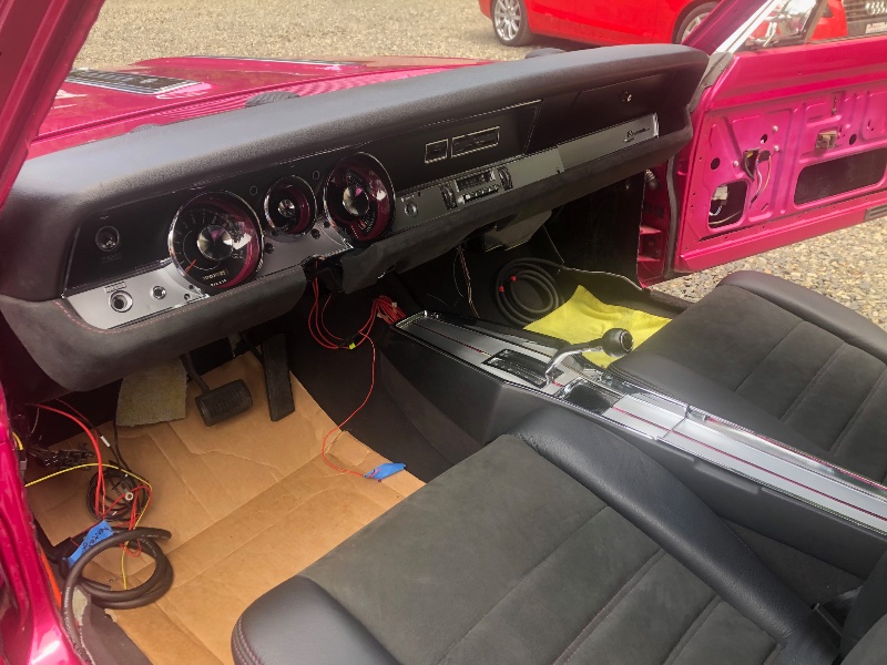

The goal and vision for the build has always been to create a distinctive restomod outcome with a classy upgraded interior, given most MOPAR interiors are seriously lacking when compared to European interiors (IMHO). Added a peak at what has been done with the interior for those interested.

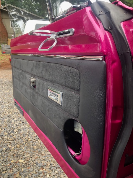

The stereo has been a major component and issue to deal with. In this day-and-age I find I rarely have an opportunity to enjoy my home stereo due to the pace of life, and the contemporary opportunity resides in time spent driving in a car. A '68 Bcuda was never designed to address quality sound, but we found a solution -- Morel Nano 3-way speakers, custom fabrication, a digital RetroSound head unit and Audison amp. Unfortunately we'd already had the interior seats, floors and panels finished in leather and Alcantara with offset stitching that matches the paint. The interior vendor took-on the difficult job of back-cutting the door panel up to the leather backing, to then tack the leather over the edges to the backside. Very risky, but they took their time and successfully made it happen. Next, we decided to drill-out holes for the tweeters and midrange, while filling-in the defrost vents, figuring they were unnecessary in a convertible. We opted to leave the original 4x9 speaker grill in the event we add an additional mono center channel to push more/clearer sound when we test this on-the-road.
From the picture, you may be asking what that is sticking out on the upper section of the door below the wing window ... It is a cup holder!!! Yet again, I found out about this modern-day solution at a car show and had to ask the build shop to make the cut-outs after the paint had been finished. Again, another high-risk move, but it worked out and delivers the "restomod" convenience one would ideally get, especially given that experience has told us water in a convertible is a necessity.

OK... I see 4 switches. Who makes the regulators? I was not aware anyone made the rear ones for our cars.
Apologies for the delayed reply ... Work and other priorities this time of the year.
This is the outfit that I used for the electric windows -- www.nu-relics.com. They were great to work with and even asked that I send in the tracks to make sure his fabrication matched what was in the car, in the event there were any variances
