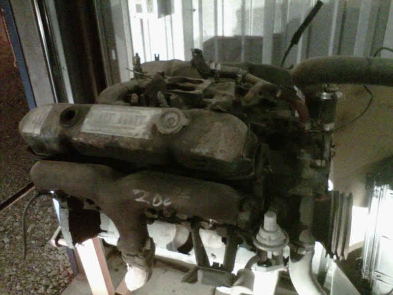

i got a 73 motorhome 440 i need to open up and see whats in it, came out of a 1 1/2 ton chassi
I got this 73 long block in my storage...I got it complete with carb and tranny for 200 bones....
heres my Motorhome 440 that I got with a 727 tranny

The tranny should have some HD internals in it , guess Ill find out when I get around to going thru it .
