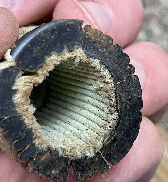

Well, I think I may have found the problem. My uncle (who has been wrenching on muscle cars since before I was born) insisted that we check out the fuel system first. Within a few minutes, a huge problem showed up.
The metal inline fuel filter that I bought from Summit last winter was rattling around when I removed it from the line. The filter element was detached and the adhesive was breaking apart, sending debris into the fuel pump and carb.
I’ll get some pics up tomorrow but it’s a mess.
As mentioned, the filter element was rattling loose in the metal canister allowing anything and everything to get past.
This waxy adhesive(?) appears to be the culprit. Some of the cracking in this material is from opening it up to look at the pleats (which had some debris).

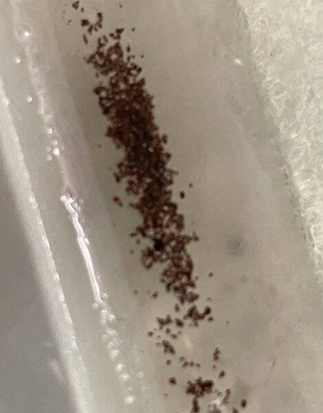

Emptying the gas from the filter into a cup showed quite a bit of debris swirling around.

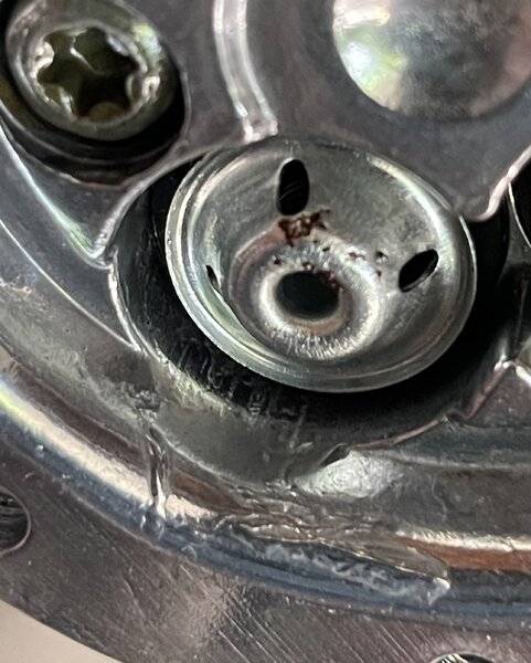

Just pulled the fuel pump, the fuel that came out of the pump has more crud in it. I’m trying to figure out if it’s possible to flush this thing out.
The pic is zoomed in pretty far. The particles are tiny.
The particles are apparently not from that deteriorating seal. They stick to a magnet. So presumably, it is coming out of the tank and the dislodged filter element just let it through.
