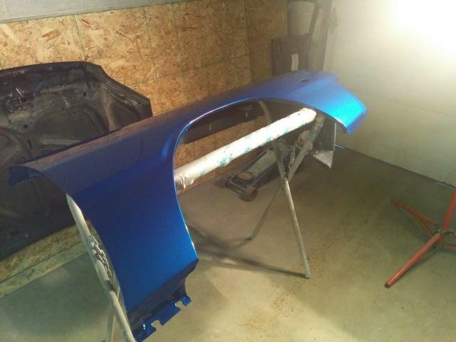

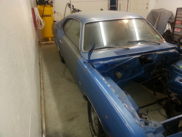

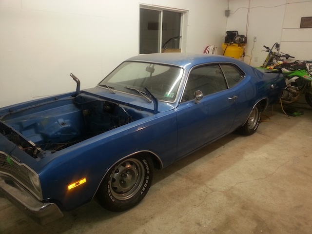

It has taken forever but i have got a few things done to the project so far. just thought it was time to start a thread and share a bit. Still have a long way to go though. Sorry the pics are just in random order.
just get "upload of file fail" does anyone know why i cant post anymore pics?
pics
pics
just waiting on strut bars and torsions and then i should be able to bolt the whole drive line into her.
built a cart to hold all my junk!
Need new headers but will use these ones for now.
That looks awesome. I'm doing the same thing to a 73 Duster (/6 to 408). Back end is all done, going to put in discs up front as soon as the weather gets better. Then will spray the money hose towards the motor. Your photos got me all antsy to get going....
Thanks! are you changing the k-member or using adapters? if you are going to use adapters i have a new set that im not using. let me know your plans! you are close and i might have a few things that you might want.
Planning to swap the K member when I get to that point. Going to drive it with the six banger for a while (money hose just went limp) - of course at 101000 miles it still runs great.
Actually just this week saw 2 local K members show up on craigslist so may pick one up and decorate the workshop with it for now.
I wish there were V8 perch to slant 6 adapters, then I'd do the V8 K member now along with the front end and put the six back in for now but oh well....
