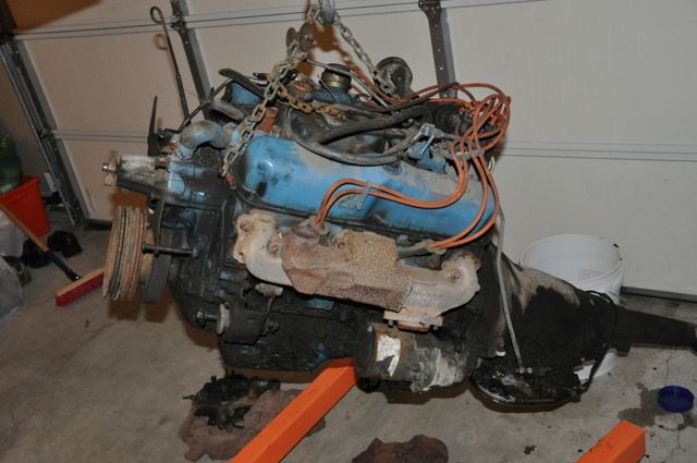

A couple months ago I purchased a turn key 360 E58 with a 727 transmission from a local wrecking yard that specializes only in Mopar stuff. I purchased this engine for a couple of reasons. 1) It's turn key ready, so I ASSUMED (wrongfully) that I'd probably be good to go with something like this. 2) Because it's the high performance/cop car engine/Lil Red Express equivalent engine and would be a good strong runner.

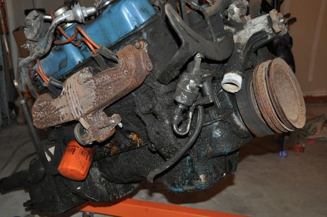

Anyway, I got the engine delivered to my garage and started down this dark road. I began probably one of the most daunting tasks of my life--cleaning the grease/grime/dirt off of this engine and transmission. After probably 20 hours and $100 in cleaning chemicals (carb cleaner, engine degreaser, simple green, oven cleaner, etc), I finally got this block just about cleaned up and down to the original bare metal and paint in some spots. I was actually pretty proud of myself with how much I was able to do by hand.

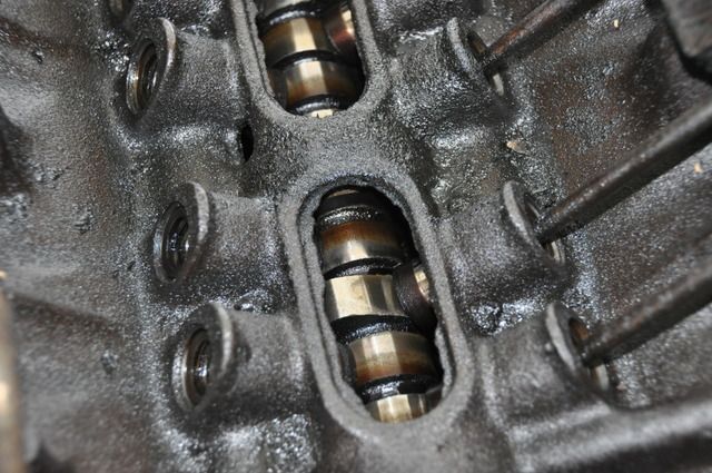

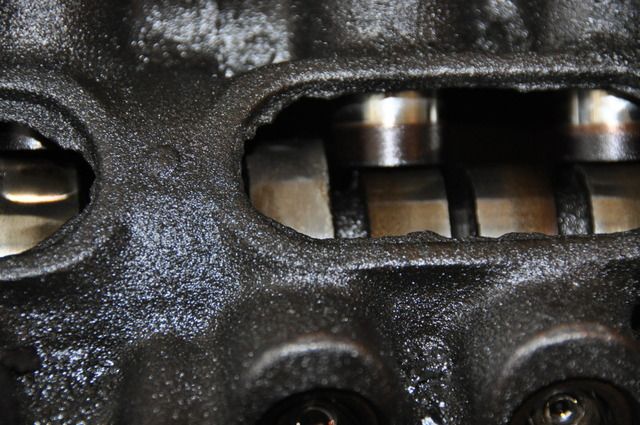

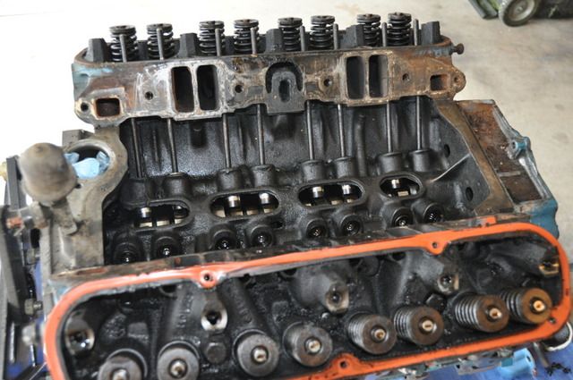

Well, dad finally came up to town and we started unbolting a lot of the old factory pieces off like the water pump, intake manifold, yadda yadda. As soon as we popped the intake manifold off I could see disaster already happening. The camshaft lobes were all pitted and at least four of the push rods were bent (the only ones that would move with my finger). I suppose it doesn't take an expert to know that either of those things are bad news.

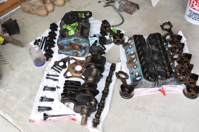

So after a long week of debate, I decided to rip the entire damn thing apart and start a rebuild project. I didn't see any major issues other than the push rods/lifters/camshaft going on.
I took the block to the machine shop along with the heads and crank. At the first brief inspection, I learned the block had never been rebuilt (which is odd, because the block had a Mopar Factory Rebuild placard tacked onto the side of it). The bores were fine and the pistons, rods, etc all appeared to be stock.

I also bet that motor did run with some pitting on the cam and a few bent pushrods. You just may never know about stuff like this until you tear it apart. I think you do have a good starting point in that E58. Was the motor and tranny $600? because that really isn't that bad for what probably really was a running e58 and 727.

Hi,
can´t see it exactly, but the trans pan looks like a 904 to me - check it out, maybe post some better pics of the trans alone.
Michael
thats normal cam ware for a high milage engine be sure to check for stuck valves

Just talked to the machine shop on the phone.
$326 for all the engine cleaning/maganflux/boring....will probably have to be bored to at least .030 over. Worst case scenario, .040 due to some wear.
$94 for the crank to be ground, unfortunately it can't be polished because it has a few scratches on it and what not.
He said something about balancing it and $200 for a flex plate and installation or something, and to be honest, I don't even know what it means to have the engine balanced.
Then some other figures for miscellaneous things/labor. Oh, and $500 for the heads to be redone.

Here is a quick reference to the shape of some Transmission Pans.....(which is the best way to identify them)...the 904 and 727 differ Greatly and are easy to identify.
http://holdenpaedia.oldholden.com/images/8/8f/Transmissions-8614.gif

$500 on the heads is that for stock valves or you going to 2.02/1.60?? at this point you might as well... the machine work looks good price wise to me, and $200.00 for the balancing of the oem crank is a good price too. IMO

I guees it depends on what you want to do with your car, the sizes I referred to were the stock sizes for the 340 of yester year, your 360 heads if they have not been modified would be 1.88/ 1.60 so you would only have to tell the machine shop to open up the intake valve size to 2.02 the 1.60 on the exhaust is good, so you would need 8 2.02 intake valves and now would be the time to do it since they are going to rebuild your heads now, I dont know how much HP you'd gain but most people do this when they have thier heads rebuilt, unless they go with an aftermarket head, ie; Edlebrock etc.

nope you can still use stock rockers and push rods. you'll just benefit more from a bigger cam as those bigger intake valves will let more fuel and air in. and you dont need to go crazy on the cam either.
The 2.02 valves won't need anything special to work and it will only cost a couple dollars more to have the installed, Now is the time to do it. That cam is kind of small for a 360, The 280 would be a better choice. Remember that you will need a converter that does not have the balance weights on it now also because of the flexplate you are using.
