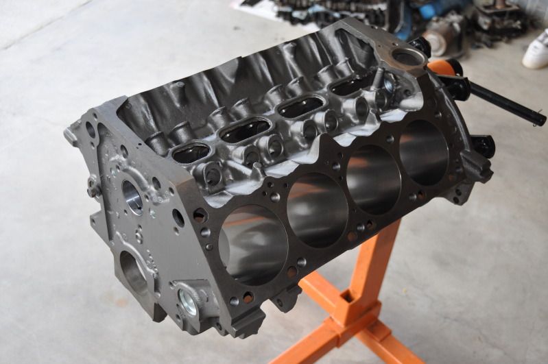

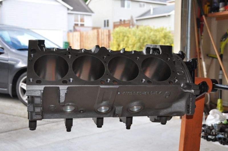

The block back from the machine shop all cleaned up, bored, magnafluxed and mic'ed.
VERY happy with the machine work done by the East Side Portland NAPA store.
With color! First engine painting job, fairly happy with how it turned out. The HEMI orange pops so much more in person than it does in pictures. I'm starting to see a glimmer of light at the end of the tunnel.

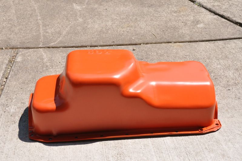

The oil pan completely cleaned, stripped, primed and painted. Had to use a drill with a wire brush and an entire bottle of simple green to clean out all the crusted up oil on the inside. Not bad looking considering it has a couple of small dings in it for a 35 year old oil pan. I'll probably get an aftermarket Milodon oil pan down the road, but I like this one for now.

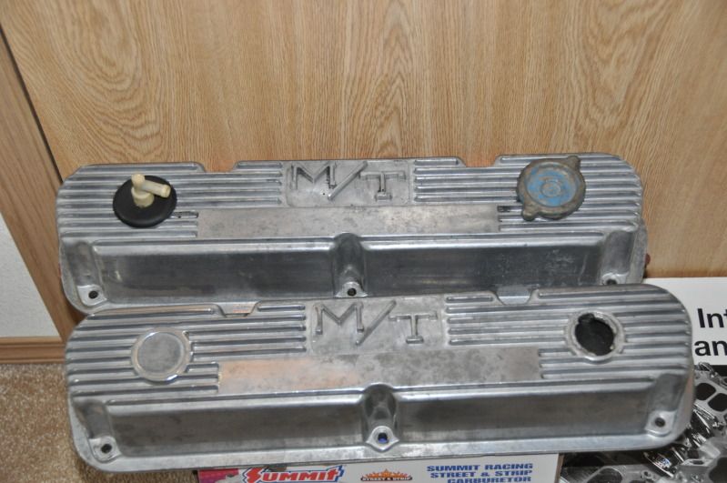

The valve covers I picked up on craigslist who happened to be another FABO member. Recently shipped off to Leanna for powder coating, and I'm very, very excited to see the finished product.

Wowwww, that's one clean block.

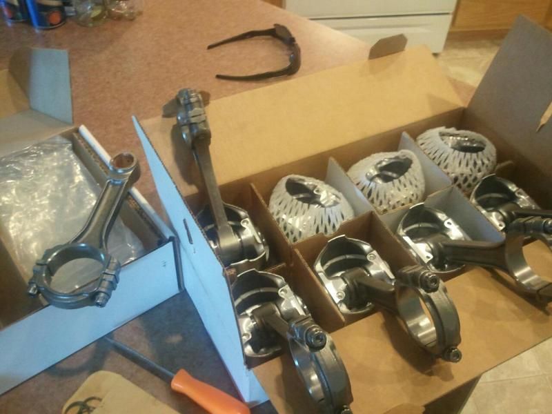

A little progress this afternoon!
All done and assembled now, just waiting for a second set of hands to help me set the crank in before these start getting popped in.
