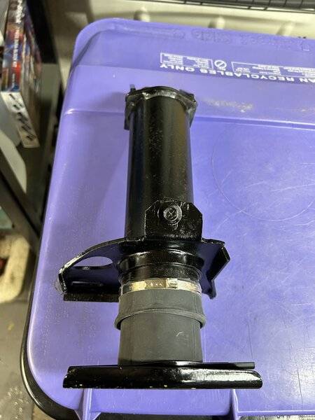

I took my front ones apart and de-rusted with Evapo-rust, primed and spray bombed black, and used a fat bicycle tub to replace the rubber. I'll find some pics and post later.
Here's some pics. The last two are from today, I haven't put either bumper back on the car yet.
Thanks for posting this. So far I’ve been unable to find any hint of a place that will overhaul these, so I’ll likely end up having to do what you did. Do you have any photos showing what’s inside the shock? In the first photo you posted all that can be seen is a rod sticking out.
Should you need more shock bumper parts, I have a pile of that stuff because I have been saving 74+ parts for years while everyone else was throwing it away.
Thanks Princess! My right rear shock is partially collapsed due to a rear ending the car took in the mid eighties. If I can’t get it fully extended again I may take you up on that offer.
The top part of the plunger was sealed if I remember correctly. It's been about 2+ years since I did them. Even the clamps I used were hard to find.

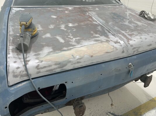

It really was. Talk about a stroke of luck! In other news, since I don't want to pay a body shop for work I can do myself I've been removing the layers of old paint and have found a few surprises. It looks like the car was repainted at least once before I got it, and not just in a few places, but the entire car. I remember thinking the finish was kind of dull looking when I got it and it was only six years old at the time, so I blamed Chrysler. Now it turns out it was a crappy repaint and not Chrysler's fault at all. I'm also finding Bondo in places where I never applied any, which makes me wonder what my Duster was getting up to before I met her. It seems the answer is up to no good. Here you can see all the different layers of paint. From right to left we first see the B5 blue Lacquer that I applied in the mid eighties, then gray primer surfacer, then a gray/green layer of sealer, then a layer of blue I had One Day Paint and Body apply in the early eighties(big mistake), then a layer of blue that I always thought was the original paint, then a very light gray layer of primer, then the original B5 blue finish that I'm now seeing for the first time ever, then a gray primer, and finally the original base layer of red oxide. Considering the car was only six years old when I got it, it never occurred to me that it would have already been repainted. Go figure.
More paint removal today and found more Bondo, this time on the right rear quarter panel and on top of the trunk lid towards the rear. What the hell happened to this car before I got it? The damage on the trunk is minor, but this nonsense on the quarter panel when combined with the corrosion it has makes me wonder if I should have the entire panel replaced while they're still available.

Meanwhile the paint removal continues and I’ve found Bondo on every single panel, and all at about the same level. It’s as if someone was walking around the car while hitting it with a hammer. None of these dents are severe, but there are too many of them to easily explain. This all happened within the cars first six years before I got it. My brother suggested a jealous or angry girlfriend went after it, but who knows.
