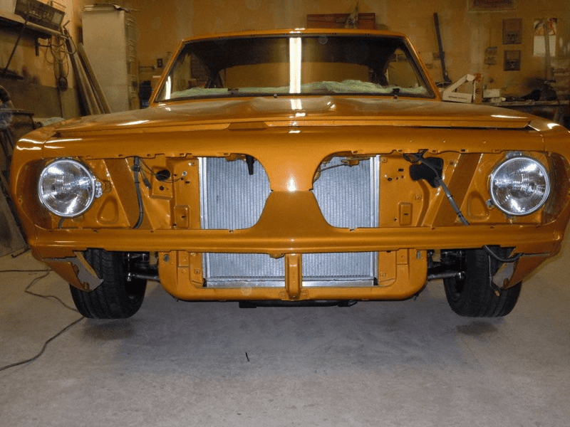

Want original looking?
Here's what Dan set up for me. Anyone can install this kit it's that easy.
It may not look 100% like the factory 7" headlights but its way closer than the smooth , clear plastic LED assemblies out there .

Wow , those look great , this is exactly what I'm looking for. Thank you!!
