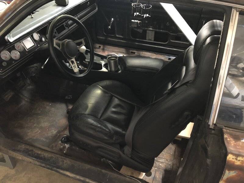

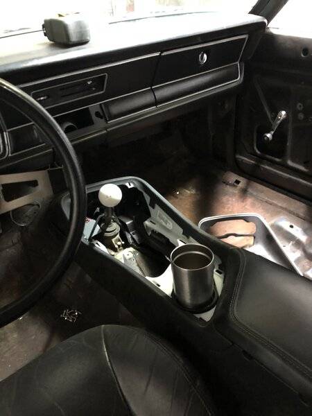

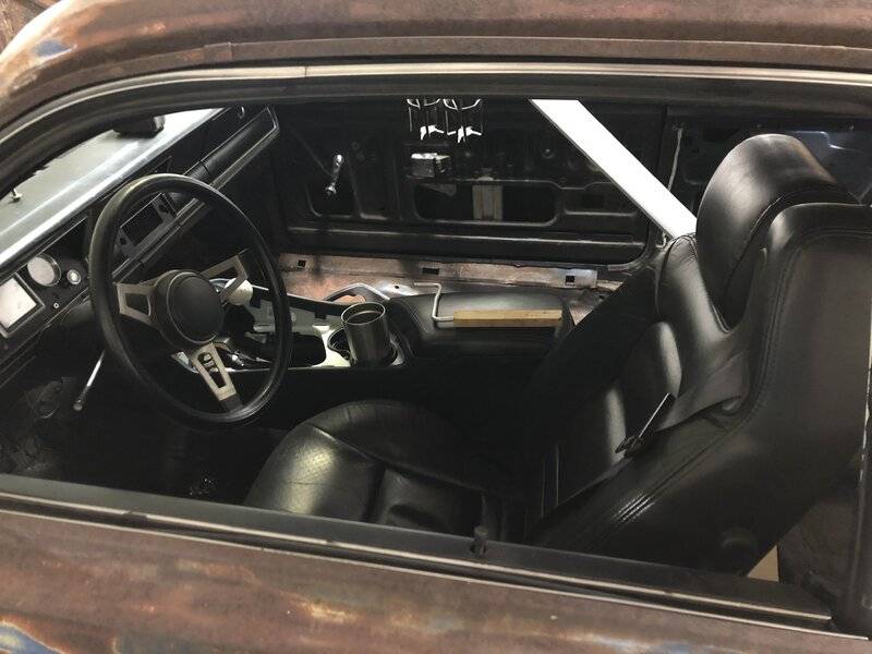

here’s the drivers seat and console set in about where they’ll be going. I hooked up a battery to the drivers seat so I could get it in the ideal spot for me. I also had Marge come out and sit in it and adjust it to where it works for her. I’m 6’4” and she’s 5’1” and I was able to get it to where it fits me perfectly and fits her well enough and if we get a wedge pillow for her to sit on, it’ll be prefect for her as well.

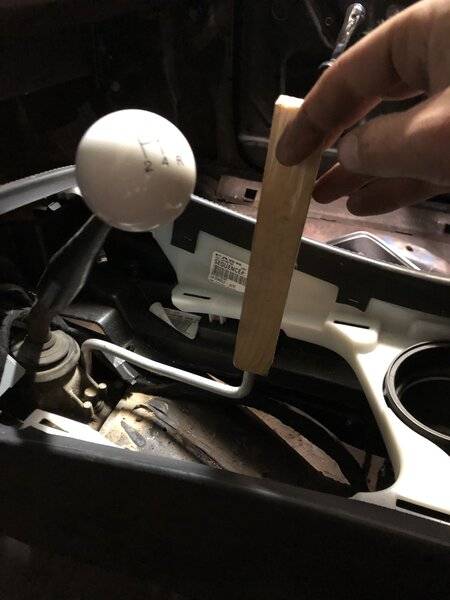

As can be seen here, I’m gonna have to modify/fab up a new shifter to fit the console. The current shifter design won’t even let the trim bezel fit in place.
Here’s a similar example as to how I’m gonna have to build the new shifter. Might even go pistol grip instead of the ball. Opinions?

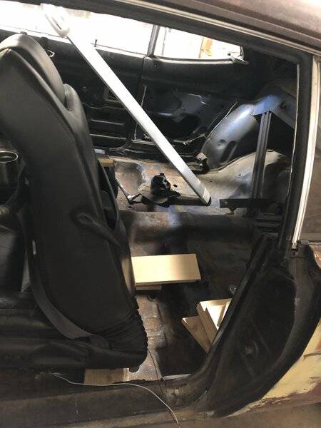

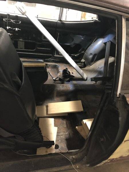

Here’s the room to get in the back with the drivers seat slid way back...
And here’s slid way forward. Look at all that room!! With the seat positioned where I have it, the seat back just touches against the steering wheel when it’s folded and slid way forward like this.

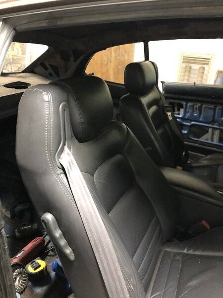

I also got the passenger seat set in place. It’s seat back is straight up to keep it from falling over backwards. Once again, I drug Marge out of the house and had her sit in the passenger seat get it ideally located. I’m pretty dang happy with how it’s turning out!

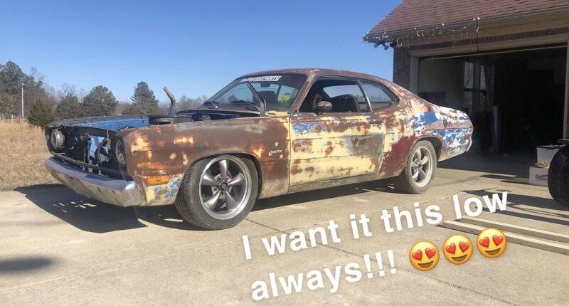

I reeeaaallly wish it was easier to install air-ride on these cars! I’d love to be able to slam the car this low when parked!
I wish I’d taken a measurement of what the original ride height was before I pulled the torsion bars and also without the torsion bars. But I didn’t measure it either way.

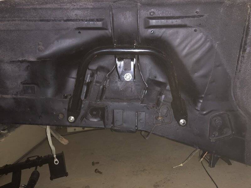

Anyway, next, I dropped the k-member and trans crossmember onto a moving dolly, undid some bolts and lifted the car off the suspension.
I then washed the engine bay and interior out some, pushed the shell back in garage and started mocking up the HDK stuff. I don’t have a 3/8 or 1/2” drill bit on hand, so I just installed the k-member and rack and also reassembled the upper and lower control arms so those are ready to install tomorrow. First thing tomorrow though, I plan to roll the shell back out again and hook up the ole power washer and wash out the wheel wells real good and freshen up the paint in there before I go ahead and install the suspension. With any luck, I MIGHT just have it sitting on all fours again tomorrow night or sometime Sunday. We’ll see!

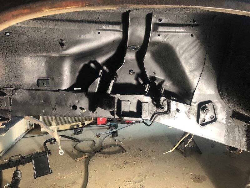

First thing I did on the car today was roll it outside (again) and washed out the front wheel wells, engine bay and the floor pans with the pressure washer. The floor pans STILL aren’t very clean, but good enough for now. Next I rolled the car back inside, mocked up the upper coil over hoops, drilled the needed holes, then disassembled everything again. I then sprayed down the front wheel wells with brake cleaner and gave them the ole rattle can restoration.
Forgot to take a before picture but here’s after I painted the wheel wells.
I then installed the upper hoops/coilover mounts for good.

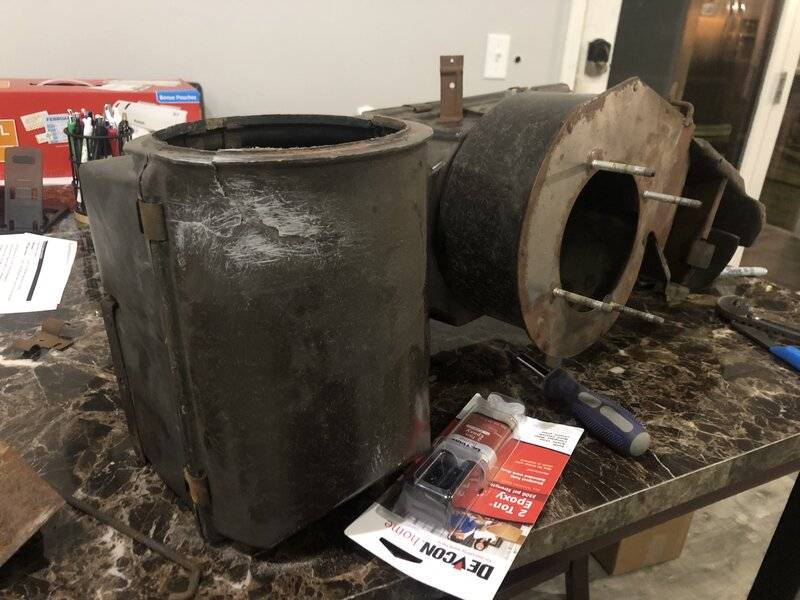

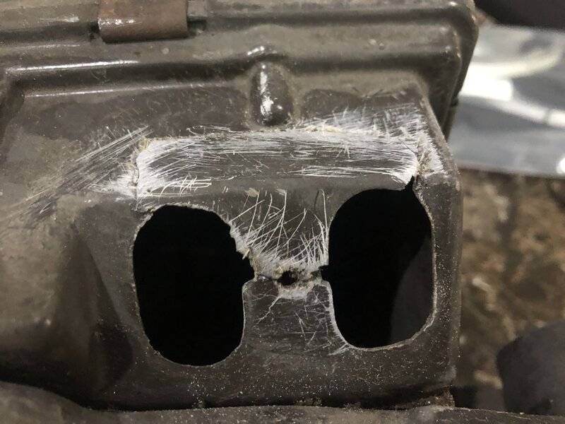

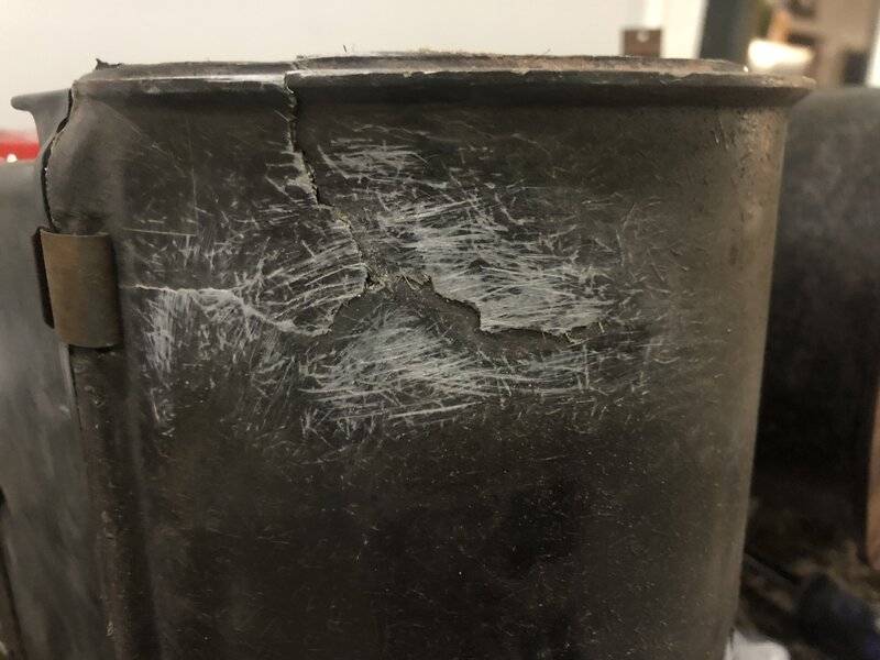

So tonight, I spent a few hours working on the car. First thing I did was pull the heater box to see about rebuilding it with the DMT kit I got last week. Upon removal, I discovered two spots on the box that were broken, so I cleaned the boxes up, sanded around the broken areas, and slapped some epoxy on it.
First spot was in the fresh air vent area.
Second spot was where the heater core tubes exit the box.
And here’s pics of both, after I epoxied them. I’ll be sanding and adding more epoxy inside and out on both spots.

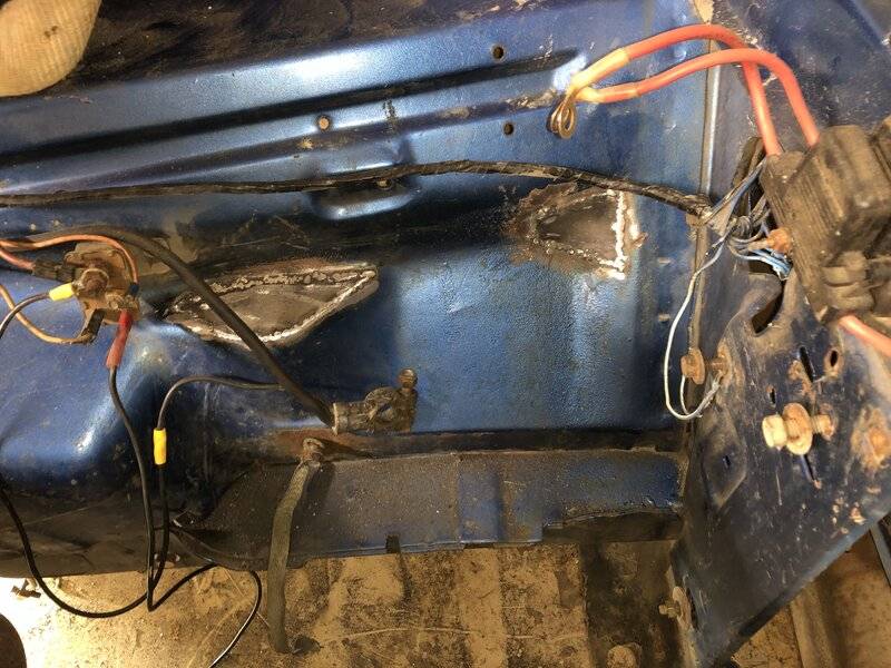

After I was done messing with the heater stuff, I went out in the garage and started working on welding up extra holes in the floor pan. I learned 2 things: 1. if you’re filling in a hole with weld, take your time and let it cool between each tack or you’ll be welding that stupid thing in 3 or 4 times!! :BangHead: And 2. It may be easier to cut the bigger bolt holes out and weld in a patch piece! Anyway... I got the whole drivers side done other than one 2x2 patch I need to make and weld in, and one small bolt hole that I didn’t see until I was wrapping up to head into the house.
It’d be nice if the passenger side would go as quickly as the drivers side, but I’m gonna have to replace the front and rear foot pans on that side so I know it’ll take longer. At least it’s big pieces instead of little holes!

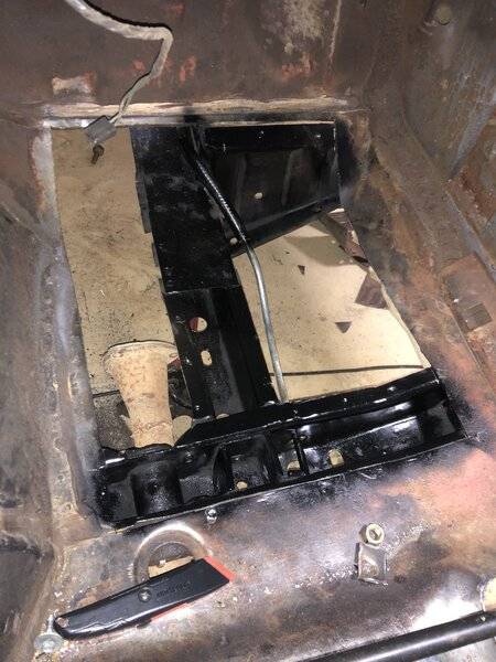

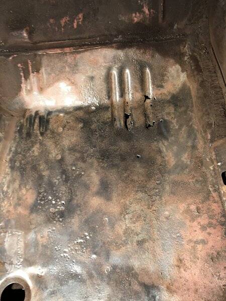

Here’s what the old pans looked like. Really not that bad but I’m glad I’m changing it.
After I marked off the floor, I cut the perimeter, then cut out where the wasn’t and frame rails.
Then I drilled the spot welds and busted them loose with a chisel and hammer and cleaned up all the rails with a wire wheel.

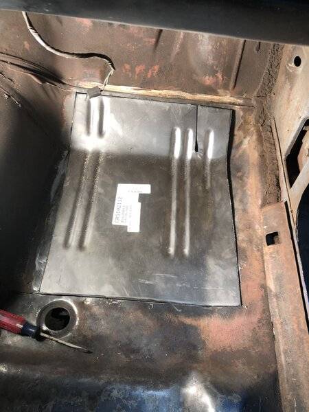

Then I test fit the piece and was pleasantly surprised at the fit the first time around. There’s a shadow along the right side edge that’s makes it look like a big gap there. The right side does have a bigger gap than I’d prefer, but it’s nowhere near as big as it looks.

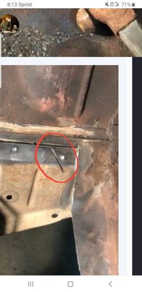

Looks like you got it to fit great. Weld up that cut in your frame gusset before putting the floor pan down. Use some weld thru primer on all the overlaps too. I mark and pre drill and deburr 1/4" holes on the new pan where the spotwelds are supposed to go in the frame. Easiest way is to trace the outline of the frame onto the pan from underneath the car. You can see how my son and I did this with the trunk pan in the last pic
Then I use self tapping screws in some of the holes drawing the new floor down tight with the frame to pin it together. After you rosette weld up the 1/4" holes not pinned with screws, remove the screws and fill up those 1/4" holes too. Heres some pix where I pre drilled and deburred the rosette weld holes and temporary pinning everything with sheetmetal screws.

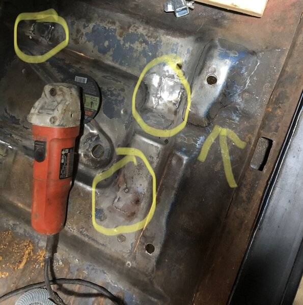

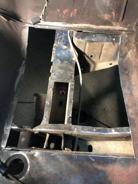

Got some more holes in the floor welded up this evening. I’m getting a little better at welding but it’s still been quite the ordeal to get the patches welded in the where there’s zero pin holes when I’m finished grinding the welds down. I have a brass hammer in storage that I’m gonna dig out tomorrow and use that to back my welds, maybe that’ll help some.

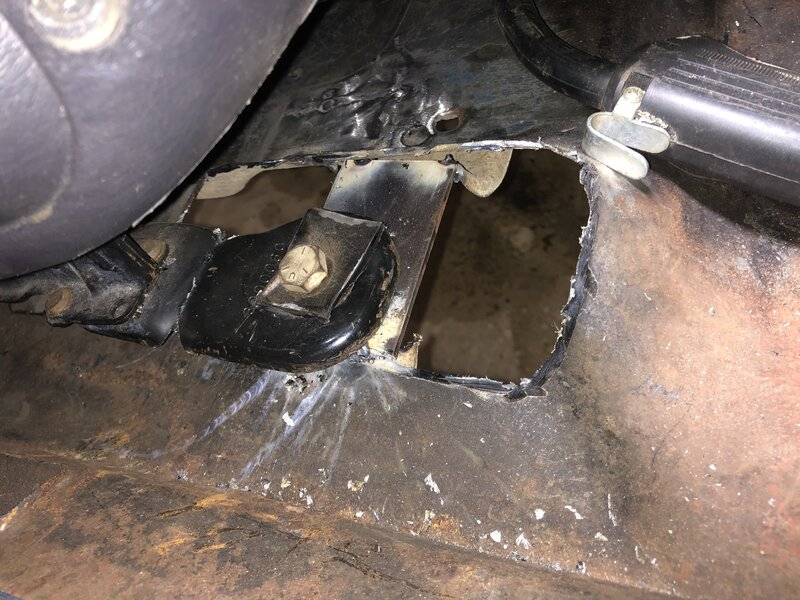

Here you can see a few of the patches I welded in (circled). The reason I took this pic though was to show the hump that the arrow is pointed at, I had to cut that hump off flat with the floor in order to get the passenger seat in the spot that I wanted it.
Here’s what you can see how I cut it off, then just tack welded a flat piece of steel in and drilled a hole in it just to position the seat where I wanted it. I’ll be remaking this piece and fully welding it on in the next few days.

I was researching how to modify my shifter to fit my console, and I found a super trick way that I should be able to do it. Wether I’ll be able to pull it off or not, my be another story. Lol

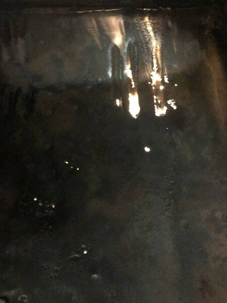

I didn’t get home this evening until 7-7:30 so it was already dark. I was planning on finishing the passenger seat mods but I got an itch to see if it couldn’t get the engine and transmission back under the car. Now, this is no, let’s do it half ways type of ordeal, since I’m doing all this in a one car garage, with maybe 2-3 feet of walking room on either side of and behind the car but there’s only about 15” between the front bumper and the garage door. So it’s not like I can leave the engine hoist in front of the car with it holding either the car or engine up.
Anyway, as I was saying, it was dark when I got home so by light of the pole light and an LED work light, I pulled the steering linkage out of the drivers header, rolled the moving dolly with the engine, trans and k-member to the garage door. Now, when I say “rolled” I mean “shoved, yanked, used a floor jack, swore a little, then used the engine hoist for some assistance”. The reason for all that is at some point, between the last time I used my harbor freight moving dolly and when I set everything on it this time, the one caster bent, causing the hard plastic wheel to dig into the side and top of that caster, making where it absolutely wouldn’t roll! What a pain in the ***!! But I got it done. Rolled everything under the car, bolted the trans crossmember in, lifter the engine with the floor jack, then loosened the motor mounts and dropped the old k-member and back out the bottom.

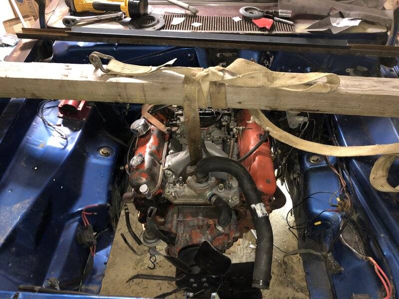

The engines being held up by the jack, the strap is simply a backup.
I was planning to install the new k-frame but I decided I may as well evaporust the k-frame bolts and paint them while they’re out, so those are currently soaking, along with the cam bolts and header collector bolts.
I don’t think I posted a picture of these patches before. I cut these out and welded them in Monday evening. I’ve never had a battery heat sensor and the metal was thin there anyway, so I cut it out and put a solid piece in. The other patch I’m pretty dang proud of, it’s sort of a concave area and I really wasn’t sure how well it was going to turn out. I made a paper template, cut out the new piece, somewhat shaped it, the tacked the one non curve side, then hammered it a little, tacked, hammered, tack and so on until it was done and it turned out MUCH better than expected! My welding/grinder work still has some to be desired. I hit those spots with some of that epoxy appliance paint. It obviously doesn’t match the b5 but I don’t care. The engine and engine bay will get prettied up when I install my aluminum heads and another cam.

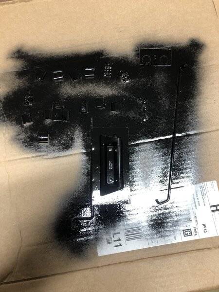

I also have my heater box hardware a shot of epoxy appliance paint. Hopefully get the box out back together and installed this week.
