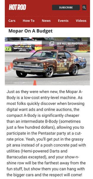

I’ll definitely come say hi! I’m planning on running my Duster in the autox again this year. I was pretty stoked when a picture of my car made it into a Hotrod article last year!

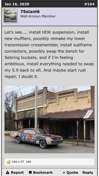

Well, I came across this post this morning in a thread titled “What’s your plans or goals for 2020 with your ride” and it made me kinda sad… I didn’t achieve a single one of those goals last year. But dammit, I’ll get most of them done this year!!
EDIT: I guess I did get the new mufflers installed last year, so there’s that. Lol

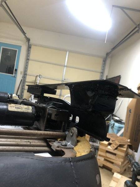

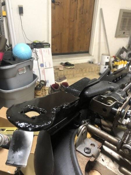

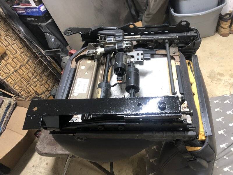

Tonight, just so I’d get a little something done, I decided to clean up the drivers seat. Once it was all clean, I flipped it over to see what all I was lacking as far as having the modified tracks/mounts finished. Found two spots that I wanted to add gussets, so I cut those out with a death wheel, (told my wife I’d like a plasma cutter for Christmas and doggone-it if she didn’t tell me she needs to know exactly which one! Fingers crossed! Lol) welded the gussets in, cleaned up the tracks and hit em with some black epoxy appliance paint. Drivers seat is ready for install!

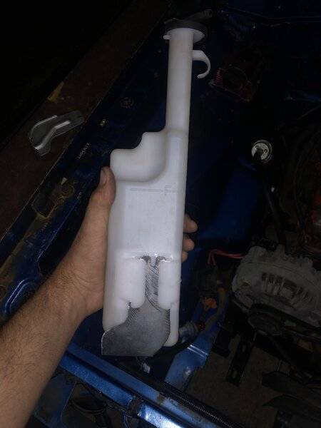

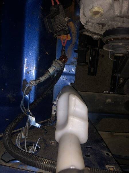

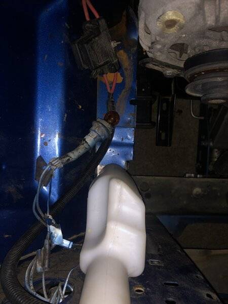

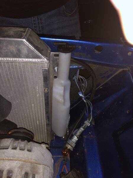

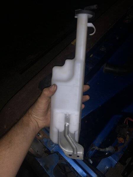

Well, I see all the posts after August 27th still aren’t back, which sucks but it is what it is I guess…. Only thing that I can think of that I had posted in that time was about the coolant overflow bottle bracket, so I’ll throw those pictures back up.
Basically, the oem Hyundai bracket design caused the bottle to sit 3/4” away from the inner fender which caused interference with the radiator. So I fabbed up a new bracket that allowed the bottle to sit against the inner fender, giving me just enough room to get the radiator in.

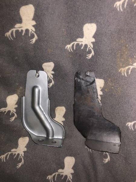

oem bracket
homemade bracket

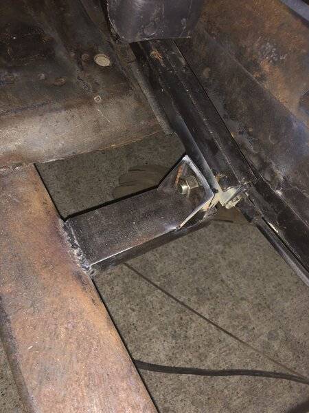

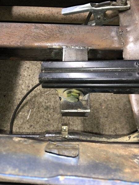

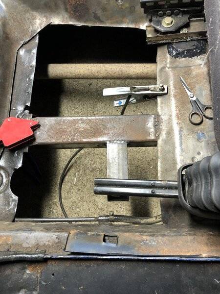

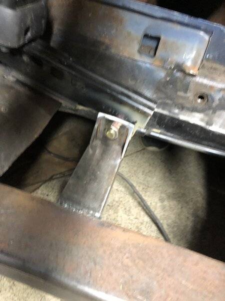

Got a couple “stubs” welded onto the subframe connectors to catch the rear outer seat bolt. Since the seat belts are built into these seats, I’m taking extra precautions to insure these seats aren’t coming loose in an accident!

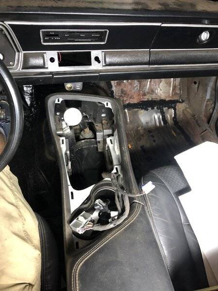

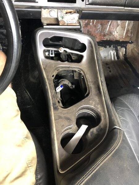

I also got the console brackets fabbed up and welded in.
While positioning the console, I made sure I had just a smidge of room between the top of the console and the ashtray when it’s open.

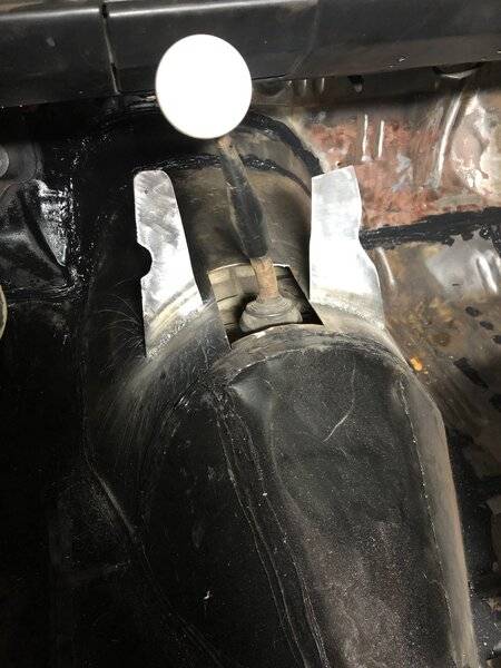

The current location of the shifter is going to be an issue, I can’t install the console trim bezel due to where the shifter comes up through. I have a plan to remedy this, I’m just not going to have time to get it done before MoParty next weekend. So for now, I’ll just run the console without the trim.
Here you can really see how the shifter is an issue…. The shifter comes right through where I intend on putting my AFR gauge.

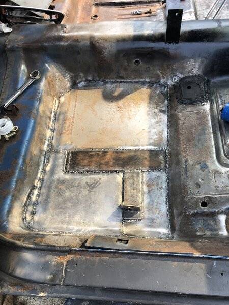

I also bought a rust free rear passenger floor pan from a guy on fb. It came in the mail today so I unpacked it, then looked at how much I was going to have to hack it up in order to work around the subframe connector and the seat mount “stub”, so I decided that first I’d try my hand at making my own pan pieces and maybe just sell the rust free pan to someone who can use the whole thing. I did get the biggest section welded in successfully but didn’t get any pictures of it. Tomorrow, I intend on spending most of the day working on the car again. Hoping to get all the welding on the floors done, paint the floors and get the seats and console bolted in, along with getting some other stuff done.
Bigger visual update tomorrow night hopefully!
Got more done on the Duster today. The 1” blocks came in today, installed those and the ride height looks almost perfect! But like an idiot, I forgot to take a picture of the car. There will be plenty of pictures taken of the car in the next couple weeks though.

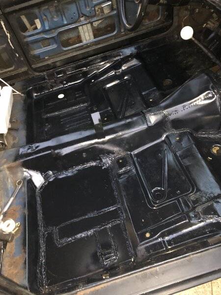

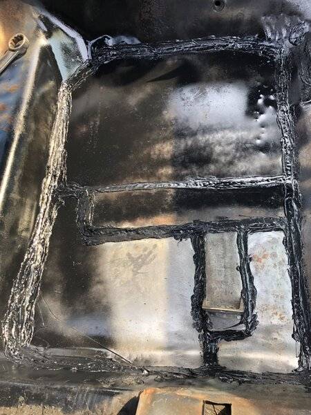

I also got the rear passenger floor finished up! For the first time since I own the car, it has 100% solid floors! It’s not perfect but dadgummit, I think they turned out alright! I finally figured out the method of closing in gaps with weld. That save my butt because I cut two of the panels a little small.
So here’s the panels all welded in.
Here’s after I seam sealed it. Almost forgot to take a picture before I had it all painted.
And finally, the floors are painted!

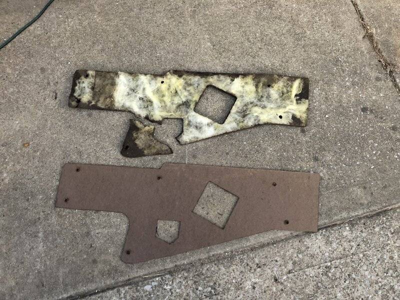

Then I started working on getting the heater box reinstalled. I put butyl sound deadener on the firewall, then took the falling apart insulation board and traced it out on a piece of fiber board and cut that out.
I also traced it out on a piece of the foil backed insulation that I’ll be using in the car and used adhesive to fasten the insulation to the board. In typical fashion, I forgot to get pics of that as well. :BangHead:
