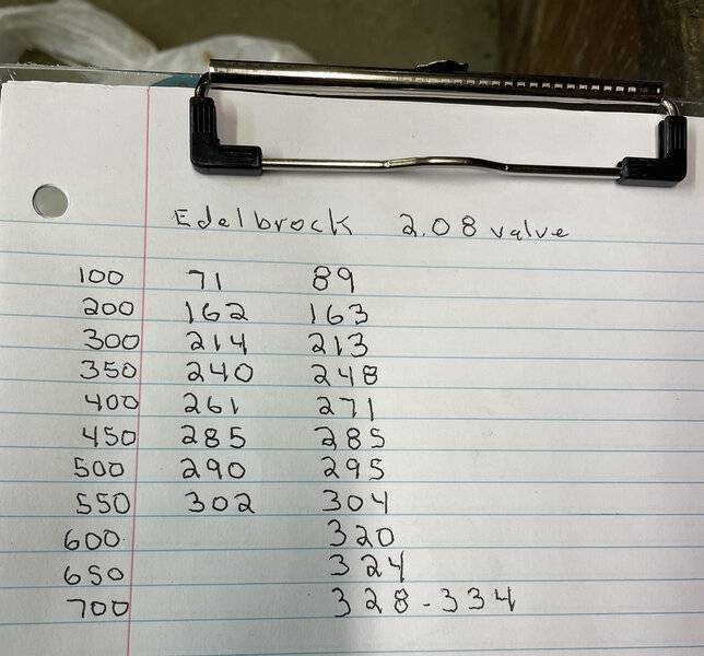

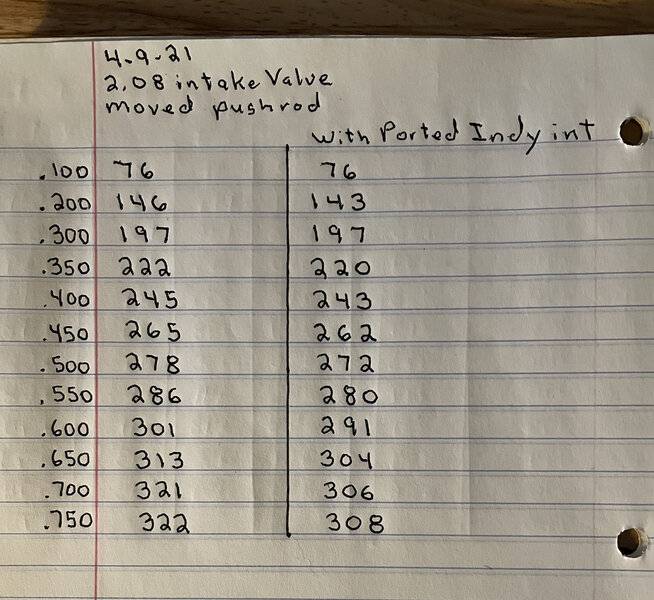

First set is the set I put hours into moving the pushrod holes only to have the modified Indy intake suck oil real bad not once but twice. Not sure if the angle is off or what the issue is, so they sit unused. 2nd set has to get put on my black duster. This is my best to date set of stock location 2.08 valve Edelbrock head. I’m not finished with them yet and they went not turbulent but flow numbers rolled slightly. Now that I’m capable of doing a better valve job and setting the throat sizing right I’m betting I can milk a few more cfm out of them. I’m betting 5.80’s are within reach.

Great heads. Especially for their time period. I’ve probably gotten asked to do five sets in the last year. Thank God I’ve had enough Speedmaster, Edelbrock, and now LS work requests.
