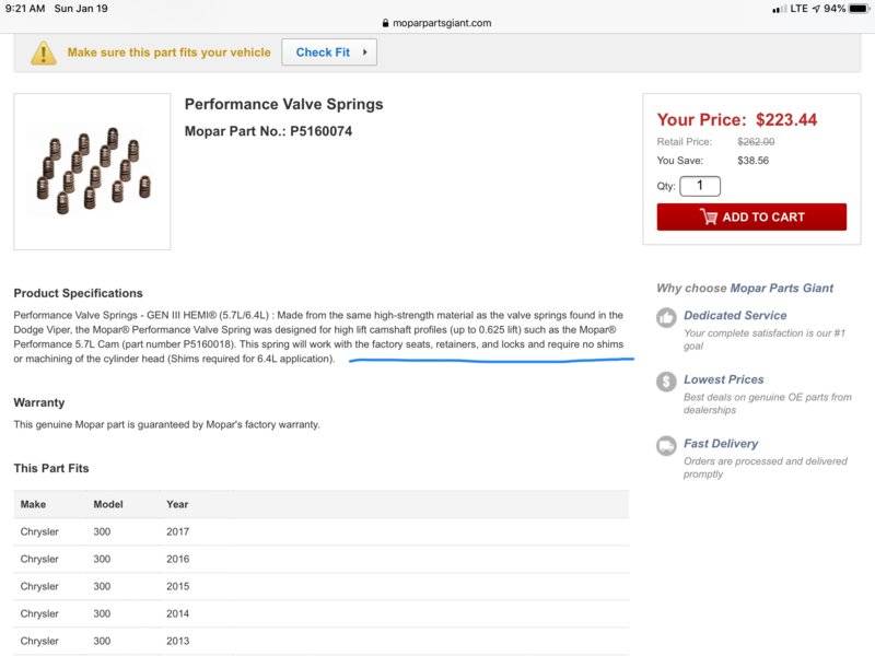

So I shouldn’t have to replace shims and retainers? I just ordered the kit in the picture but wondering if I will run into a height/spring bind if I don’t put in smaller shim. To me, best I can tell, it should be as easy as old spring out, new springs I ordered back in. Swap cam, have the MDS turned off in programming, and push a new tune.
I make mention of Hellcat cam only because I think what I may do is go down the road of this 6.4. Then when/if I see lifter issues, I may swap with HC cam, MDS lifter delete, and a little boost. And it sounds like the springs I ordered should handle either scenario.
Does this all sound about right or I have missed something?
I am assuming the MP springs would be set to the stock height(1.99 Inches installed height)on the 5.7 Eagle heads and need to be shimmed for the 6.4 Apache head(2.051 inches installed height) to put them back to the 5.7 installed height of 1.99 inches. Yes use the factory shims, retainers, and locks from the 5.7 Eagle heads, as far as I know with the MP springs. Yes to the cam MDS turn off and new tune.
