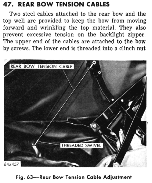

I have not dealt with mine as my car is in pieces and have the top frame stored in the rafters of my garage. But I did check the FSM I have and I see there are cable adjustments listed starting on page 23-30 in section 47 that contains a pic. Posted pics of that section here in case they are of help.
Nice information! also very helpful. It seems these cables were added in 1964. maybe some did not have them? Found a bullitan about it and took a picture of them but still need the rear attach spot?

I think the most important part is adjusting the rear cables so the bow is at the correct measurement.
