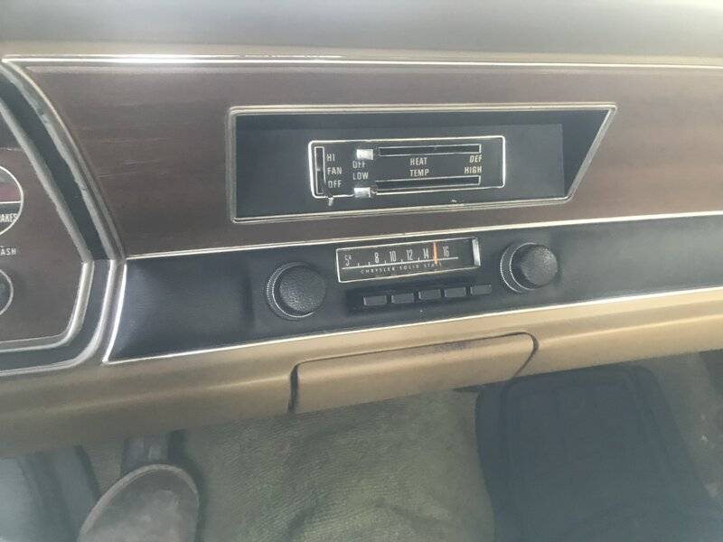

Where and what’s best way to access lightbulb for dash heater control knobs on 72 Scamp ? Anyone also know bulb number ?
It connects on the back of the plastic Heater control housing top side.
Your 72 model heat only controller may not have had a backlight. You might pull it and find a provision for a light.

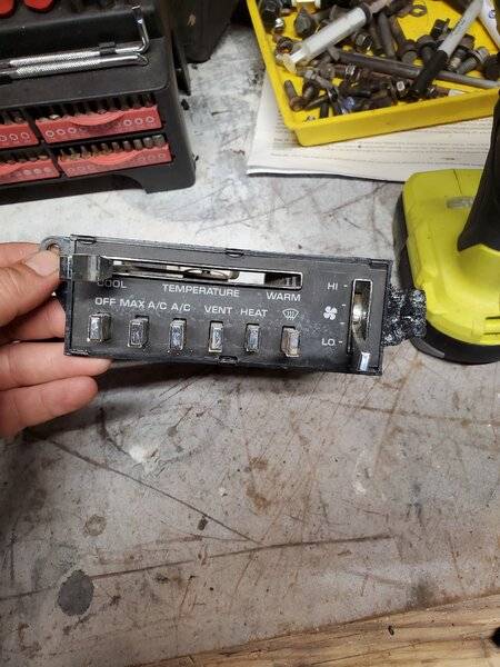

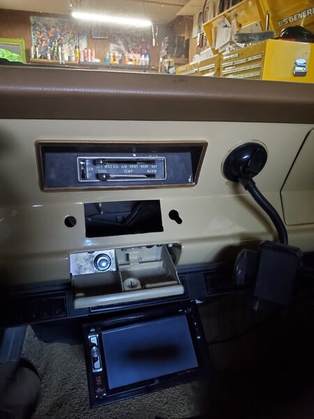

Deltatech. My heater control doesn’t look like that. My 72 Scamp heater control is identical to my 76 Dart heater control.

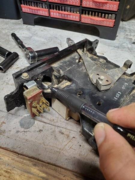

It's in the same location.That was just an example to take a picture of that I had laying around from a 91 D100. I've changed them out laying in the floorboard and reaching up through the back of the dash and around the back of the stereo.
