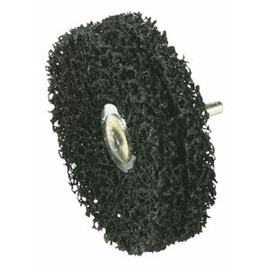

Where can i get these wheels at? Are these the same as the plastic stripping wheels that i've heard of?
Im a cheap **** so I buy one of these- stripp.jpg and knock the arbor out and mount on my grinder, you get two wheels for the price of one. You can get these at sears, HDepot, Ace etc...
Ya I bought one but havent used it yet. I was going to compare it to a wire wheel and a flap wheel.
Im a cheap **** so I buy one of these-View attachment 151779 and knock the arbor out and mount on my grinder, you get two wheels for the price of one. You can get these at sears, HDepot, Ace etc...
These things work great!

I ended up ordering the set from the link i posted above. I did decide to go with the HF stud Welder though. I tried it out yesterday and it worked fine but the slide hammer is junk as someone said. It won't grip the studs and just slips off, good thing i ordered the uni-puller. I got the stripping pads as well, one for my angle grinder and a set for my die grinder. They work great. I'll look for those videos on YouTube, thanks for the suggestion.
