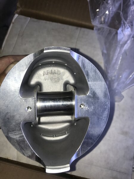

Have a nice set of 340 +.030 pistons. Forged, Domed.. .984 pins
But no #s or other markings to ID these. Any idea how to tell manufacturers and comp ratio ?

That's a good mystery, look like nice pistons other than having no coatings.
I think I remember the CR being 12.5-1 and they are forged. They look to be too modern of a piston to be old TRW's. They have 1/16 top and second ring grooves. Those would be a good match for some nice H beam rods....lol.

My guess? (Note, GUESS!)
TRW/Speed pro with some of the dome milled down
Maybe why there's no i.d.
I would go along with that were it not for one thing. The insides of the pistons are much smoother and more finished than the old TRW and Speed Pros. These look like a more high end piston.
I'd maybe even say Arias. I have an NOS set of 351C Arias pistons and they look similar on the bottom.
that's a solid guess. their finish was generally very nice.
i'd say wiseco but i'm guessing there's no W on the skirt... but... when did they start adding that? *eyebrows*
You got me by the short hairs.
The old Arias and Ross that I've had had a rib around them below the pin, missing on those.
And 2295s (domed 440 trw's) had 1/16 rings 50 years ago.So did the 340 version.
I'm NOT saying they are trw's, the bottoms inside do look awfully nice, but they look more like trw's than Arias or Ross to me.
Either way, cr is a guess, with a lot of other factors determining the actual number. But low eleven to low twelves would be my guess.

These are the pistons we got from Steve, on the H beam rods. I'll ask him if he remembers what the heck they are.
