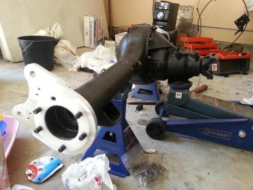

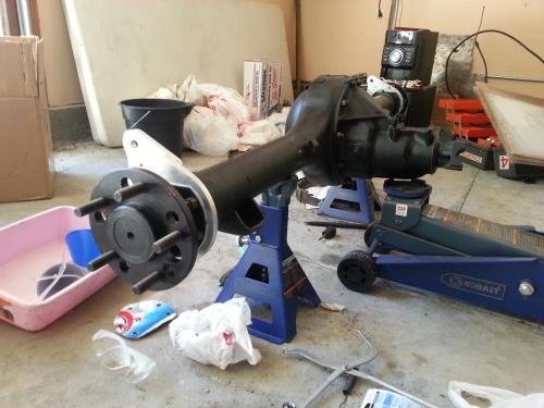

I'm going with Doctor Diff's kit, but I got his 13" disc brake kit with the fake Brembo's. I already installed the rear 11.7" kit with Cobra calipers. I'm going to start the fronts maybe next week. What I like about his rear kit is it can use the factory tapered bearings which tend to have a longer life than the Green bearings.
However, since it doesn't seem like your budget was as high as mine (practically non-existent) I would say you should probably do Wilwood's in the front and Dr Diff in the back. That way you still have a lightweight 4 piston brake up front with a good 1 piston caliper in the rear. If you don't like the mismatch, I'd say either all Dr Diff or all Wilwood would be fine.
