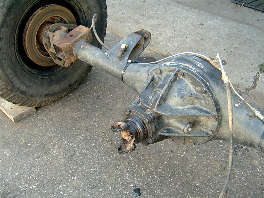

I picked up a used diff and none of the casting numbers match anything I have found listed. It has the older axles in it so I assume its a pre 1964. Any help with IDing this thing and possibly retrofitting newer parts would be a huge help.
3rd member casting number= 1327888-2
Also has a 135 above it.
I cant find a casting number on the carrier, and the lugs on it are bolts threaded into the hub.

The more I look at your pictures the more I believe that is not an 8 3/4. But, I could wrong, it won't be the first time.
Unfortunately that's what I was afraid of. I can't find any info on it at all. The pinion yolk is different than any I've seen also. Not entirely sure where to turn for some info either.
That looks like a 1930's-1950's Chrysler 8-5/8" or 9-5/8". The rear axle used under early Dodge Trucks (and under the front of WM300 Military Power Wagons), it was the axle that inspired the 8.75" and the 9"
It's probably about 62" wide from WMS to WMS, right? If so that's a 1948-1953 B-Series (Pilothouse) Truck Rear. Most Likely has 4.78, 4.89 or 5.13 Gears in it.
It's 53 1/2 backing plate to backing plate, and 41 from perch center to center. Well, that would explain why I can't find any info on it. Not the diff I need for sure. The drums have straps with springs around them.
Perches should be about 1.5" or 1.75" wide at most, if I remember correctly (The B-series trucks ran very skinny leaf springs). I can't remember if they were 1.5" springs or 1.75" springs though. Which is sad, because I have a stock (not for long) 1948 B-Series truck and I've been around the differential and springs in it a lot, replacing shackles, brake lines, etc.

It does have 10 studs. The pinion seal is 4 inches in diameter. So most likely a 9 5/8 assembly from an early dodge or power wagon. The perches are 2 1/4 wide, if I can nail down a type I can hopefully recoup my money. Thanks for all your help. I would have never thought to check that old.
It was supposed to go in my 67 dart. Just finished the 340 and am looking to get rid of the 7 1/4 for the 8 3/4. What I get for not checking numbers before I forked over the cash.

That is no 8 3/4" center section! Also, no configuration I've ever seen regarding the shock mounts directly on the spring perches!! Probably not gonna work under your dart!! :-(
Even though it looks like an 8 3/4" it's actually an 8 1/4" that dates back as far as 1937, it did have 10-spline axles and some had 16-spline axles.
The old 8 1/4" has 11 attaching fasteners instead of the 10 that the 8 3/4" has...

What size are the wheels? 14", 15" or 16"? Look on them to see if there is any id? The screw in lug bolts are a clue, 1955 was the last year for DeSoto and Chrysler and 1958 Plymouth. I think Dodge mostly used studs???

They are 15" wheels. They have the chrysler pentastar on them with a 13 next to it. Also it has a "Detroit" u-joint installed.
