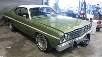

I am in the progress of patching in some spots on the body that needed attention. My car is all original, and numbers matching. The body paint code is GF3, Amber Sherwood Green. The problem I am having is when we ordered that color, it is a darker green than my car. If you do a google search of "1973 Plymouth Duster Amber Sherwood Green GF3" and select images, you can see two different color greens. My car is the lighter color green. Does anyone know a mixture code or more information to be able to match the color? I need some good advice from the painters in our group. Thanks

The top example car you copied is mine. I can ask the paint shop if they have the mix codes. I must tell you that my mix does seem to have more 'gold' metallic sheen than I bet was OE.

So far I heard that they shot my car with DuPont Cromax Pro basecoat mixed per the standard Plymouth 1973 GF3 Amber Sherwood Poly codes. I will post anything more if they have stored tint ratios.
The bumpers and bumper guards are rechromes by BumperBoyz from LA. I swapped cores when they came out to a big show meet in Charlotte.
