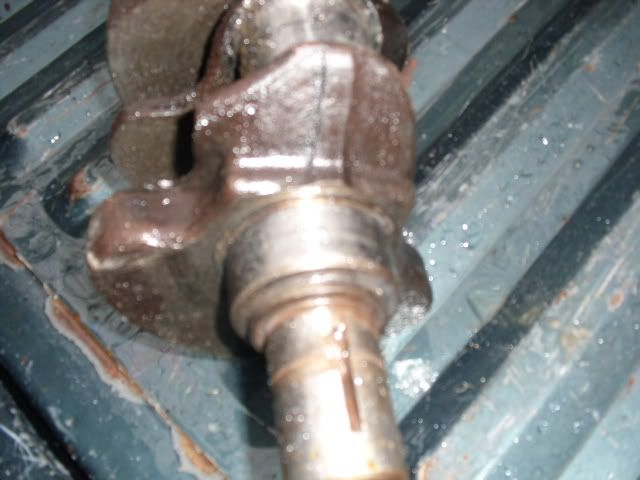

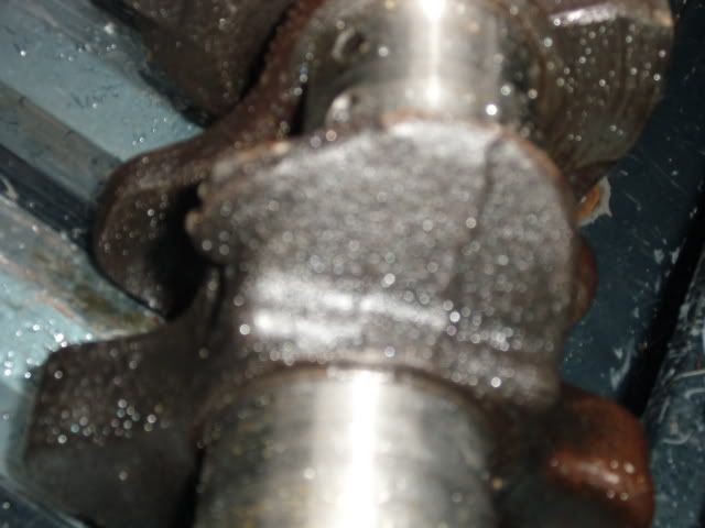

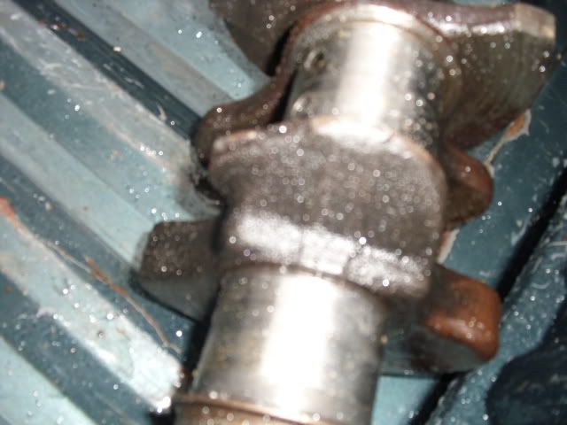

The books that I have show that a 1967 318 crank is forged, what does the parting line look like? Post up some pics and someone will tell you for certain what you have.
I am pretty positive I do not have a forged crank.....I would say cast.
all the surfaces are rough like cast, it has a "casting seem" down the center of the weights.
I will try and get some pictures
How wide is the seam running down the middle? Cast cranks will have a larger seam while forged will be narrower. Can you post a pic for us?

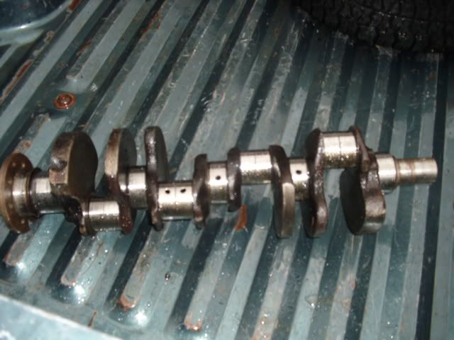

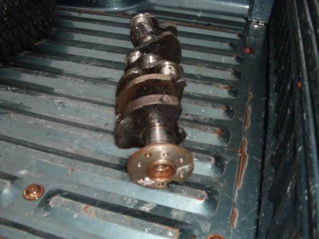

Ok so it looks like I have the wide seem? but at the same time it looks like my crank weights are squared off? the link you had sent was for a 440....does the same apply to small blocks? sorry for the pics guys but its the best I can do right now...I toss the crank in the back of my truck because I am only using it as a core on my new crank and it rained today.

..........Thats a forged crank in ur pics....it is a 318 crank.......340s have the 2 end throws drilled with a 1in hole 2 balance 4 the heavier pistons and rods.........kim........

Hey It's supper time all over North America. That is a forged crank like Kimmer said. Dimensionally there is no difference between the cast crank and forged crank so yes you can use a cast crank in that engine. Where the problem enters is that if you go to a cast crank it will probably be an external balanced unit whereas the forged crank is internally balanced. This means that if you choose to buy a cast crank you will also have to replace the vibration dampener, torque converter flex plate and possible even the torque converter with units that are meant to be used with a cast iron crank. See it ain't so easy.
