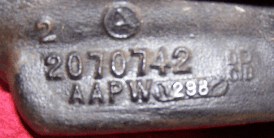

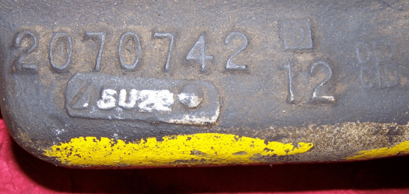

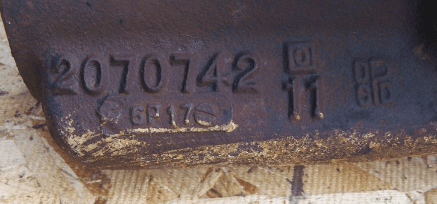

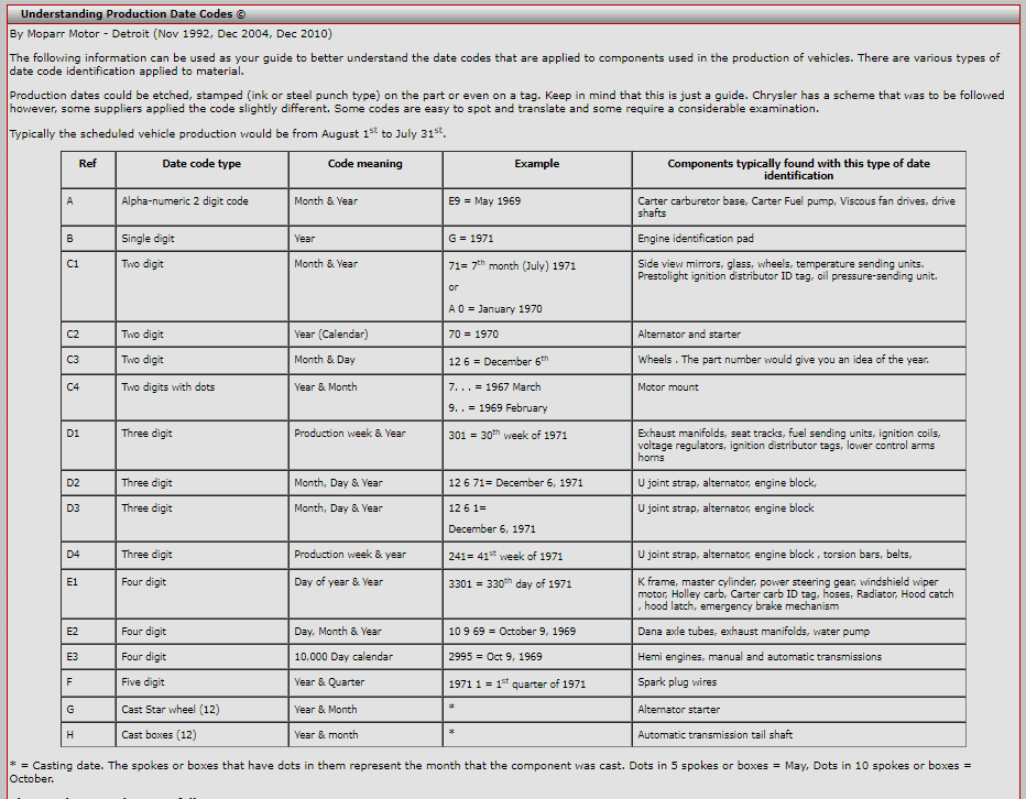

I'm looking for a 742 center section and have seen many available. I would prefer to get one with a date code in mid to late 66 or Jan 67. I can't for the life of me figure out the date codes. Some have 3 or 4 numbers, some have number-letter-number-number. I have searched google for a definitive answer and have come up with the following:

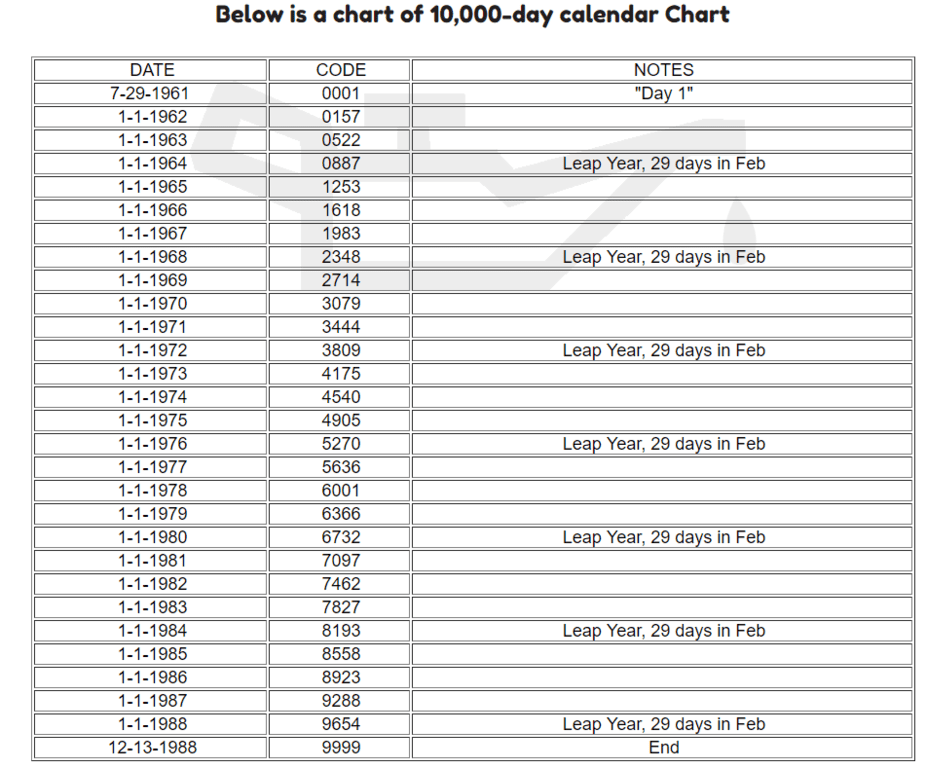

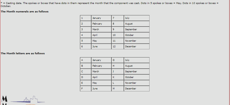

7M13 = 1967-12-13 or YMDD with m=12 (no use of "I" in the code) from a website explaining
6031 = 1966-31st day of the year (my guess from other date code websites)
These two make sense
But what about:
6P17
5U22
232
M12 (741 case)
What am I missing

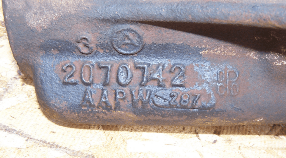

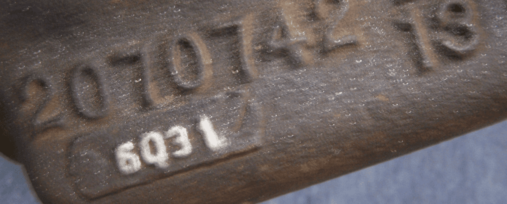

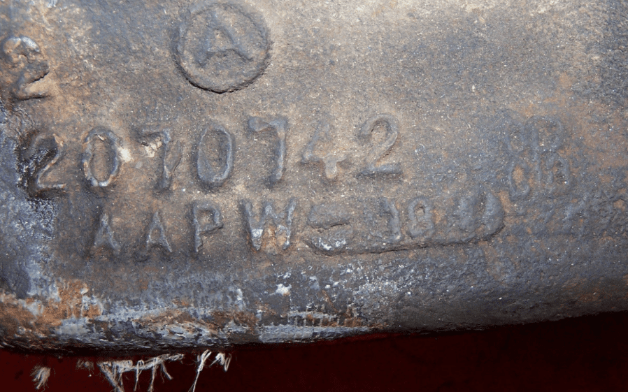

Thanks Kim, Unfortunately most of the cases I'm looking at don't have gears and most of the ones that do don't show that part of the ring gear.
I'm still baffled by the date codes, unless they are not date codes but some other casting mark that is screwed into the mold right under the part number on the drivers side.
Here are A few
