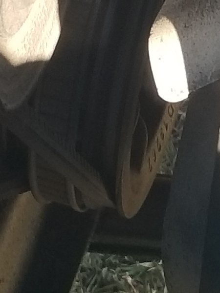

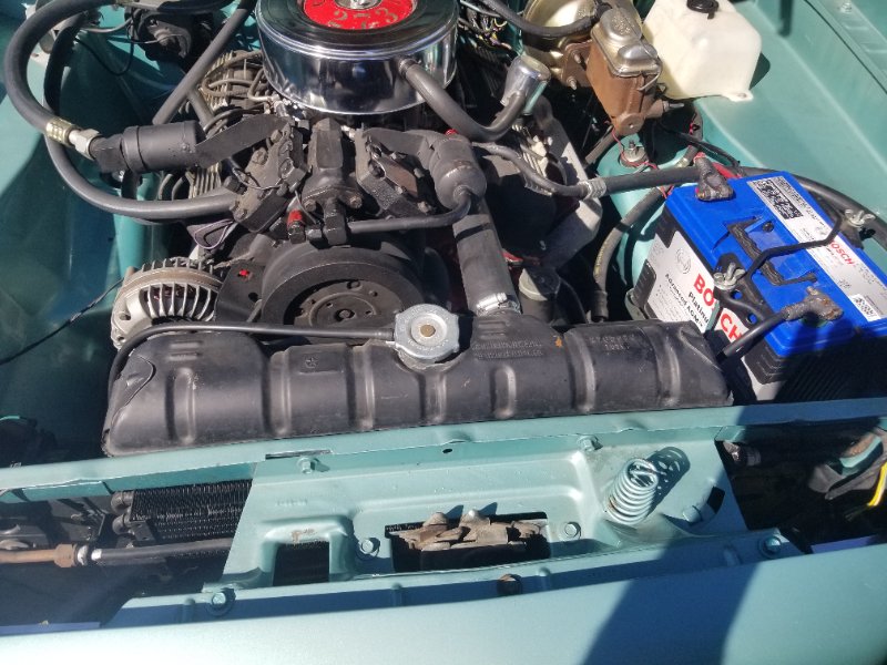

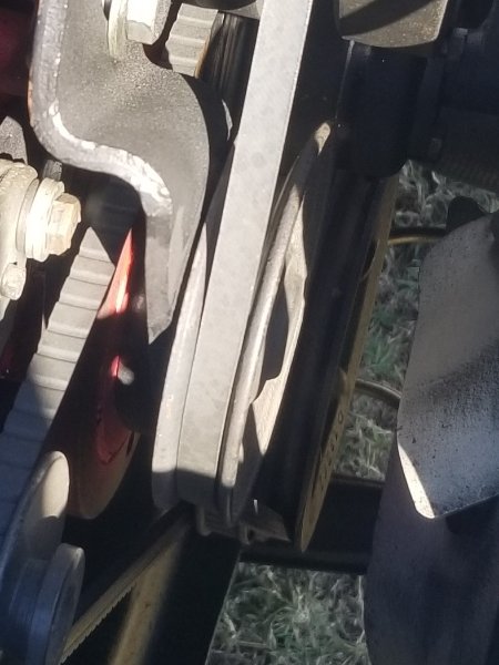

Hello All,

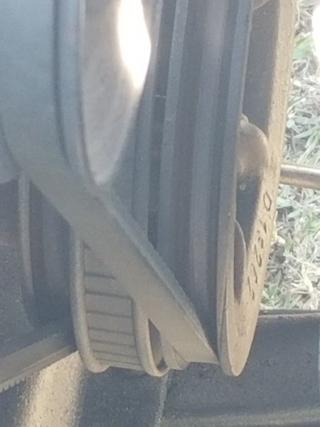

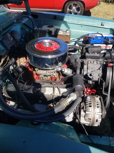

I was at the Fall Fling yesterday and spotted this 3-belt crank pulley on a 67 Barracuda Commando Car with P/S & A/C.
Unfortunately, I couldn't find the owner to ask about the crank pulley.
This pulley didn't have the usual rubber damper A/C pulley I have seen on most 273/Commando's with A/C.
The A/C appears to be factory installed. I believe the number stamped on the front of the A/C pulley is D1362 (See pictures).

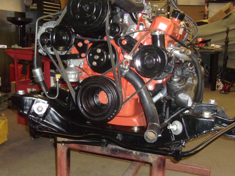

The picture on the bottom is the A/C pulley I have, and am accustomed to seeing on 273 A/C cars.
Any help with identifying this triple crank pulley is much appreciated.

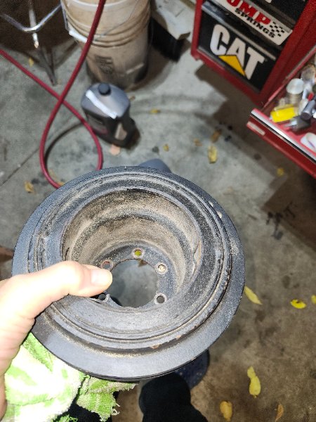

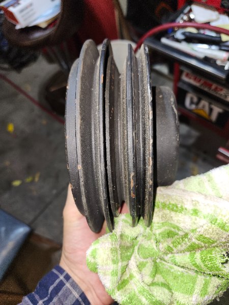

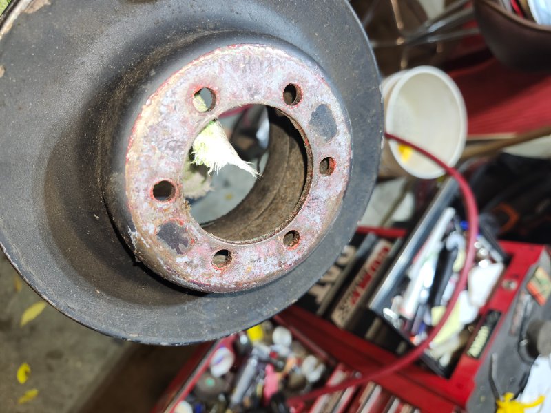

hey man good talking with you yesterday!
seeing your pic, i'm 99% sure that's an aftermarket add on single pulley to the factory dual pulley. i have one kicking around here somewhere, i'll dig it up and snap some pics.
These are the pulleys with the rubber damper on the outer A/C pulley. The one I posted pictures of at the top with the number stamped in it does not have the rubber damper A/C pulley.
it looks very similar to this:
in case you can't make out the wiriting:
D13262-6 ACME
it's for an aftermarket AC set up
dims: 6.5w 3.5t (mount base to front lip)

The original A/C pulley has an isolator (thick rubber section). That isolates the vibration from when the AC compressor comes on. They were used to ensure that there was no chirping from belt on the front end accessory drive units. A solid pulley will also work but may make noise. 65
Cool tidbit of info, thanks! I wondered why ours had rubber on inside.

That Acme pulley is a quite rare aftermarket adapter. It is cast in a foundry by the Acme corporation that is not a subsidiary of the Chrysler corporation. In the 60's as we all know it was not as common to have air conditioning as a standard option on a car as it is today. And we also all know Air temp was the Chrysler subsidiary... So what happened here is the dealerships had a boat load of cars without factory air and customers that wanted those cars with air. So the dealerships scrambled to install air at the dealership in any way they could based upon what the individual owner of the dealership decided. They are not impossible to find but not as common as factory installed crank pulleys. You will find these ACME aftermarket pullies on Mopar, Ford, General Motors tractors etc. I wouldnt be surprised if you found one on a windmill or hit or miss pump. So if you have a chance to snag one get it my friend!
