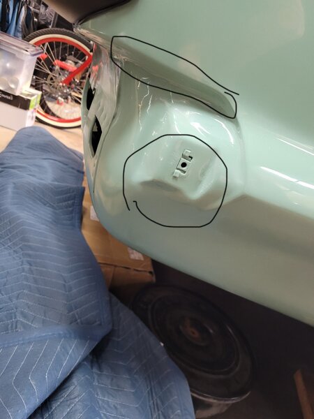

I'm getting ready to mount my rear bumper and I'm in need of what I'm guessing is a rubber vibration bumper. I've looked all over and can't find anything sold as a replacement or even a picture of what I'm looking for. If you have an info on them or where to get them please post up.

On the 2nd pic there’s a special rubber bumper that is attached with a special (of course) shouldered bolt and another flat rubber bumper that’s attached to the underside just above the location of the first one as marked onnthe pic
EDIT: after i get back from the DRs I can take pics of the bumper and shouldered bolt
First...there is this rubber bumper that attaches to the quarter panel....
GG-287, Rear bumper snubber - PLYMOUTHS ONLY, $28.95 each, in stock
Then.....there is this rubber cushion that attaches to the top of the rear bumper....
GG-309AP, Rear Bumper To Quarter Panel Cushion, - (PAIR). These are the cushions that fit at the corners between the paint and the top of the bumper. PLYMOUTHS....$34.95/PAIR, in stock
