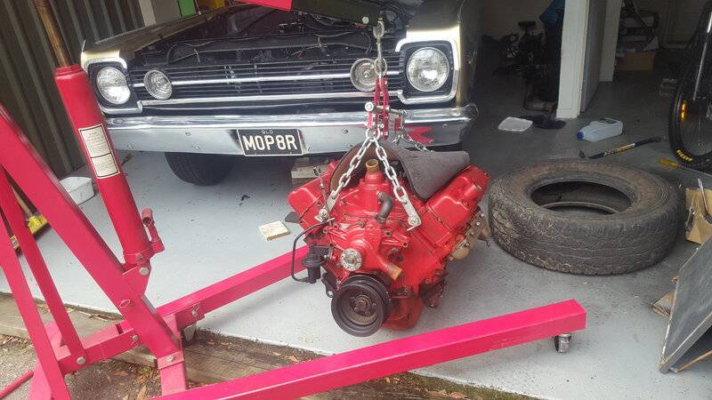

I was wrong on my earlier post sorry. Below is the correct weight from when I did it (thread on B Bodies)
There's a lot of conjecture about the weight of a 318 poly. "As heavy as a 440" some have claimed (a 440 weighs 670 lbs according to the info. I've found). Hughes Engines "estimates" it at 600+ lbs.
Anyway, mine is out, about to receive a stroker crank, and I weighed it.
I used 2 bathroom scales, with 150kg (330 lbs) capacity each, with a piece of timber between them to put the engine on.
The engine with exhaust manifolds, cast iron intake, forged crank, stock rods, 0.060 bore, cast pistons, fuel pump, water pump, engine mounts, but without starter, carb, fan or alternator weighed 550 lbs.
I weighed it a few times, shifting the scales and the timber to centralize the the weight, and it kept coming up the the same. I never did get both scales reading half each (275 lbs), depending on where the scales were it would always favor one or the other, but I'm confident it was fairly accurate.
The load leveller (11 lbs) and timber (5 lbs) were also in that weight.
Lighter than I expected, but still pretty heavy pulling around on the engine crane.

Thanks for that! Definitely not the pigs they're made out to be.
The scales I used were cheap and I wouldn't be surprised if it was out by 20 or 30 lbs.
From memory the period articles I've read discussing the transition from A engine to LA the weight difference was always about 45 lbs. With the starter, fan, alternator it could run close to 600 lbs but folk who say they pulled out a poly and dropped in a 440 and the nose went up without touching the torsion bars are tripping.

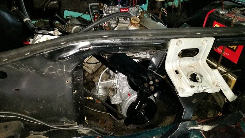

Here's a pic of the front of my 277 when I was putting it back together after installing the timing chain. Did a little cleaning/painting while I was at it. My 277 did not originally have a vibration damper; I put one in from a 65 318 poly, along with the fan and crank pulleys, and the 318 poly timing tab (also used on 273's). Fan is a NOS 56 Plymouth fan. Notice the gap between the damper and the timing tab. The tab closely hugs the damper on the LA (and later A) motors, mine is probably an inch away.

Here's a pic of the front of my 277 when I was putting it back together after installing the timing chain. Did a little cleaning/painting while I was at it. My 277 did not originally have a vibration damper; I put one in from a 65 318 poly, along with the fan and crank pulleys, and the 318 poly timing tab (also used on 273's). Fan is a NOS 56 Plymouth fan. Notice the gap between the damper and the timing tab. The tab closely hugs the damper on the LA motors, mine is probably an inch away.
Oh LAWD! The timing covers on all the early polys and hemis were just dreadfully HEAVY. Especially the Chrysler Firepower truck motors. I just BET by swapping over to the Hot Heads cast aluminum timing cover and the Big Chevy aluminum water pump that I got rid of 75 pounds off the front of that thing. It was ridiculous. VERY heavy duty, though.
Yeah, I was seriously considering swapping to an LA aluminum timing cover until I found out that wouldn't work. Well, it would fit the motor OK, but the fan would end up in the wrong place, maybe even hit something.
FWIW, the new timing chain and the Mallory distributor are LA pieces that just dropped right in. LA fuel pumps OK, too, although I'm running a NOS 318 poly fuel pump - a rebuildable Carter that looks like today's Carter street/strip pump except for 5/16 inlet/outlet instead of 3/8.

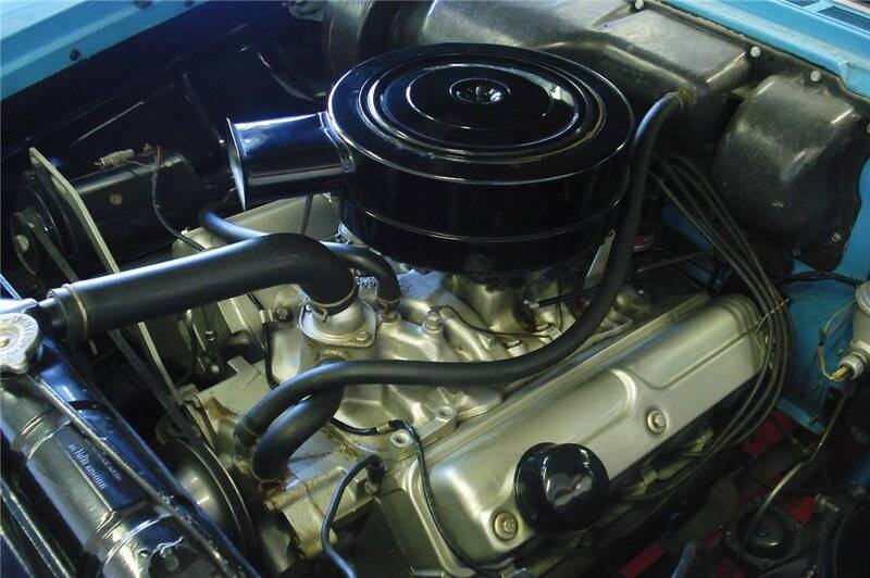

And here is a 57 301 poly (which has a 318 bore, 277 stroke, i.e., 3.91 x 3.125):
Edit: Looks like the timing cover on this is cast iron, too. Not sure when they went to aluminum. Also note that, like my 277, each valve cover has three bolts. I believe it was 58 that the center bolt was dropped and A motors from then on only had two bolts per valve cover.
