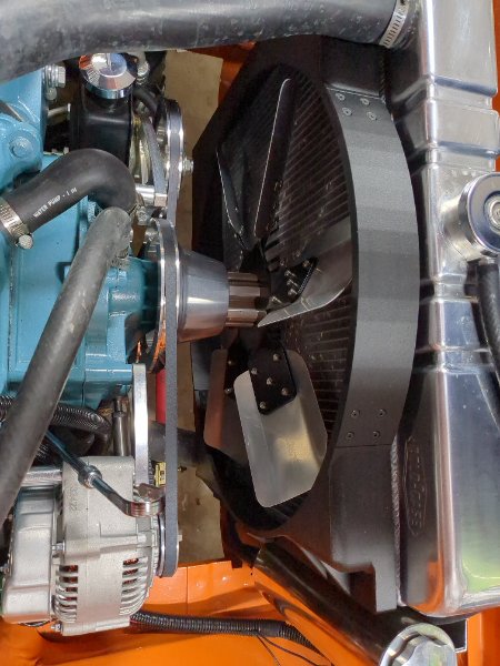

Needed a custom fan shroud, so I printed one.

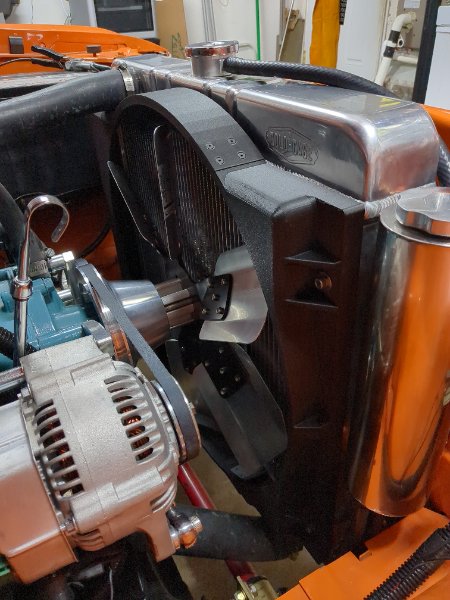

Given my bed size it took 6 pieces to pull it off but my first try worked out ok. Might need to make it shallower. Radiator is a Cold Case and Fan is 1" from power steering pump so I can't move it back more. Material is PPA-GF on a Bambu X1C.

I'd have to go back and see in the slicers for exacts. The spool of material was 0.75kg, had to reprint a few pieces to get it centered and fix a few clearance and design flaws and still have maybe 1/3 of the spool. Maybe used 1/4 of the spool. My goal was to look close to stock.

Yes. Stock put the fan inside the shroud. Tried to modify the stock one and that went no where. On this one I think I could pull it back another 1/4" to be centered. Figured if it broke or I needed to reprint it for any reason I'd adjust the depth. Its about 2/5 out and 3/5 in the shroud.

Is the top piece that looks bolted removable? That sure would make removing the fan, clutch, water pump repair situation a bunch easier. Was that planned?
It is and you can remove the top 3 pieces as one assembly. I installed and assembled it around the fan in place with the bottom 3 pieces assembled.

Very cool. I’ve got an X1C too. Did you design each part individually or did you need to use the slicer to make them fit the bed? I’d be interested in seeing the cad to see how you broke it up.
I first designed it in SolidWorks as one piece then broke it up into 6 pieces based on 10"x10"bed size and decent places to split and fasten the parts together. I'll attach a image of the model when I get home.
