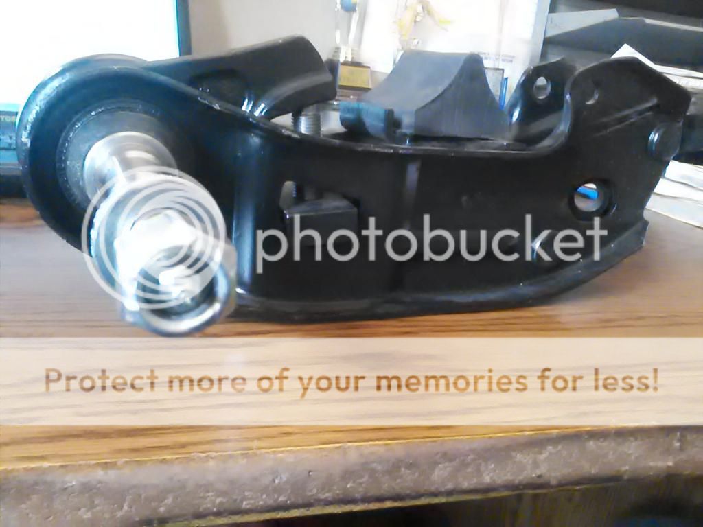

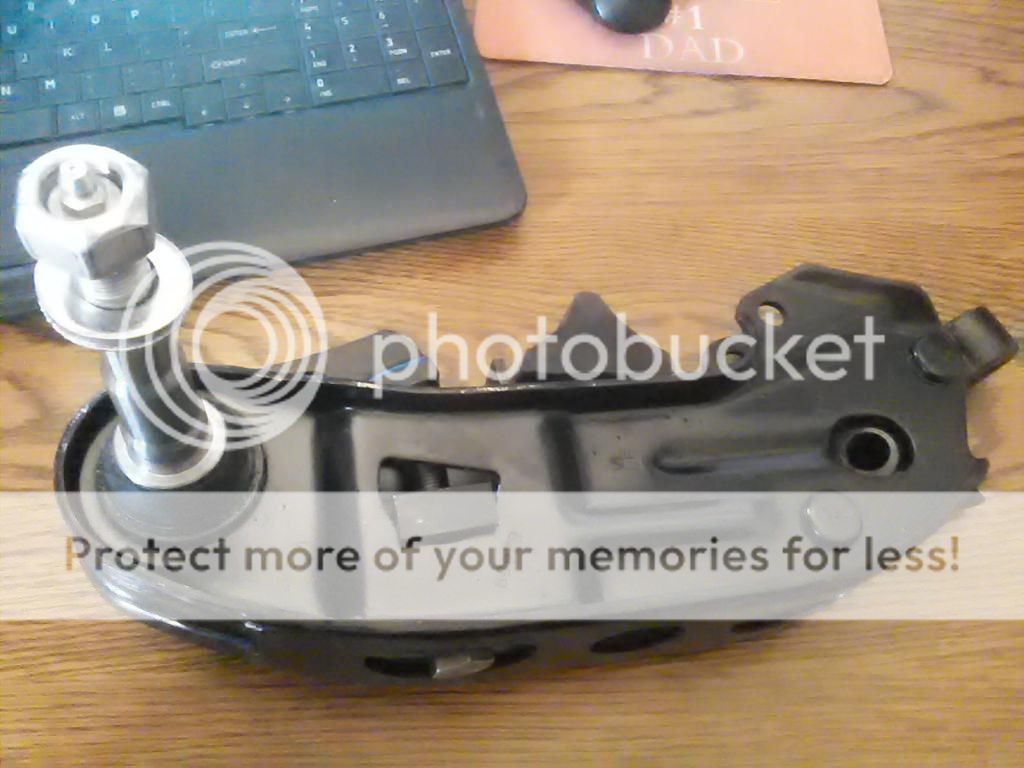

So I picked up a set of these greasable pivots along with all the other front end goodies for my 73 Duster. Without actually trying to press the shaft into the bushing and the whole works into the LCA, it seems like you can put it all together by hand. I could be wrong but if so, what holds the LCA on the shaft once the car is back together? The Torsion bar? Maybe I'm missing something - can you shed some light on this for me?
Thanks, Larry
I understand what you are explaining exactly. Are you doing this with the parts in your hand or have you already installed them in the arm ? There is a crush factory so as you install the sleeve the bushing and the shaft it will get tighter. The pivot shaft is the pivot point for the k member to the outside portion of the suspension (meaning the control arm). The control arm and pivot shaft are held in part from forward and backward movement by the torsion bar from the rear and the strut rod in the front. I hope this explanation makes sense. If not please feel free to call me and I will do a better job over the phone.

Here is one I pressed one in last night.
