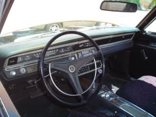

Fari enough, here are some pics of my '69 Dart GT. These are about three years old, on the day I bought it.
Interior, looks different now since 90% of it is ripped out
