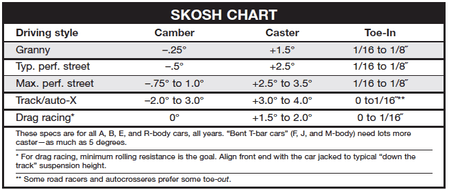

The numbers above are a decent starting point. There is such a lack of understanding on the matter of alignments. These cars were built with skinny bias ply tires that almost nobody uses anymore, Radial tires give better ride, handling and wear. Even if this car is a dedicated drag car, you can benefit from more caster and less camber than stock.
Those QA1 uppers are designed to move the upper ball joint back for high speed stability. If he's using stock specs he may not be able to get the upper eccentric to work. But as pointed out you don't want stock specs. Use the skosh chart and put a jack under the K frame and jack the car up an inch from the rest position. This is closer to where the front end will be when your doing top speed.

So, the factory specs that are for bias ply tires, and call for positive camber and negative caster. Or, in other words, the exact specs that the QA1 UCA’s are manufactured to correct.
The design of the QA1 UCA’s adds positive caster, and allows for negative camber at the same time. The specs you need to use when you have radial tires. Those UCA’s were specifically designed NOT to run factory specs, which is why that shop can’t get to the factory specs with them.
Use the SKOSH chart, if they won’t then find a different shop.

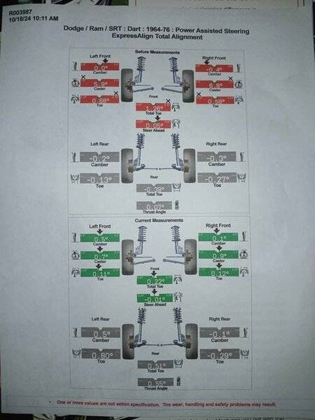

The funny thing is, there’s more than one thread here where an alignment tech told someone their control arm was too short. I’m not sure what they’re teaching these techs, but I’m pretty sure “your control arm is too short” is slang for “I can’t get the machine to turn the little box on the monitor green”.
But it doesn’t help that the machine is trying to get them to dial in +.5° of camber and -1° caster so your car drives like a shopping cart with radials on it. Especially when you have aftermarket UCA’s that are designed so you can have -.5° camber and +4° caster.

Nowadays pretty much all of it looks like this, and the techs just turn bolts until it goes from red to green (borrowed from another thread)
They’re not learning suspension theory, and there’s a good chance none of them know that some of the specs in that computer for passenger cars are for bias ply tires, because it’s unlikely any of them are old enough to know bias ply tires were factory equipment in the ‘70’s. Much less know that the alignment specs are different for a radials than bias ply’s, let alone WHY they are.
