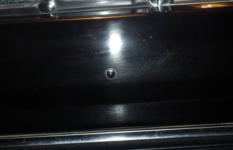

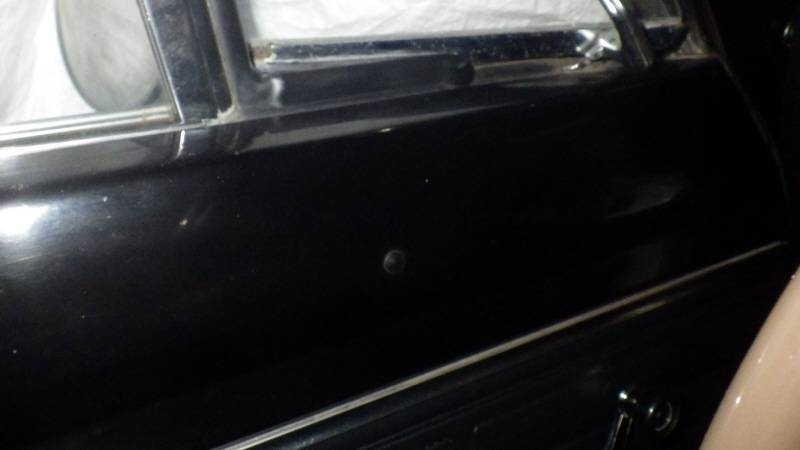

Same thing on the passenger side just tin...........
Here's a better on I think.......
Well alrighty then. I plan on using poverty pack mirrors so now i have to decide on a painted wilkie button, or patch up the hole and bodywork it.

I have a complete body plug kit it has everything but that. Prob because cars without the mirror dont have a hole cutout on the inner panel like daves69 has shown on his car. I can weld up the hole but just wanted to put a snap in cover over the hole that looked somewhat like it coulda been factory. This way if i decide on a remote mirror later on i can easily put one in.
