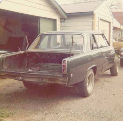

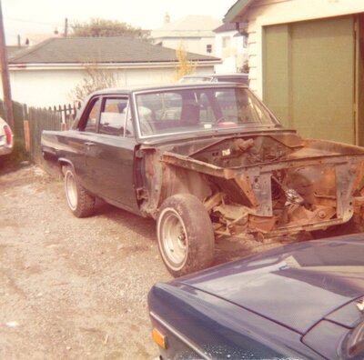

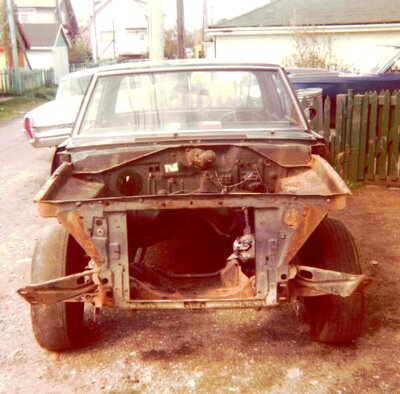

Here it is after removing quite a bit of the sheet metal and cutting out the inner rear wheel tubs.
Fortunately for me I worked as a shop foreman at a custom fabrication business which allowed me unlimited access to work on my Valiant after working hours. So after stripping the car down I towed it to the shop and would work on it in the evenings and weekends.

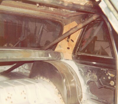

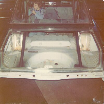

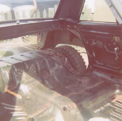

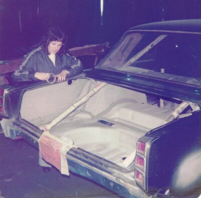

The first things I did was fab the inner wheel tubs and install flush with the outside of the stock unibody frame rails, then a 4 point roll bar, and frame connectors. After that I had the the whole undercarriage sandblasted
