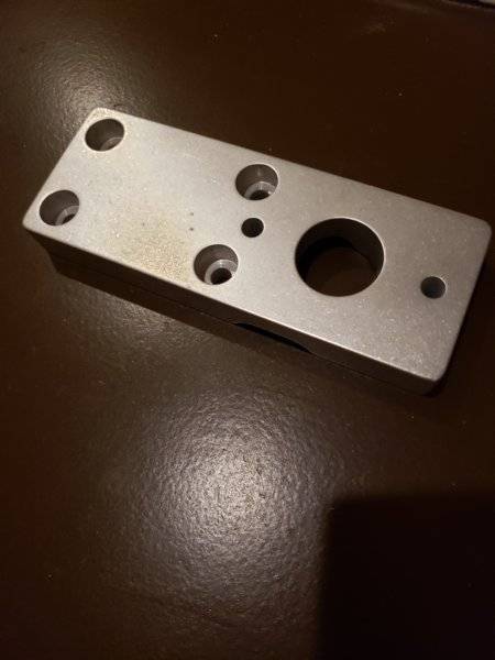

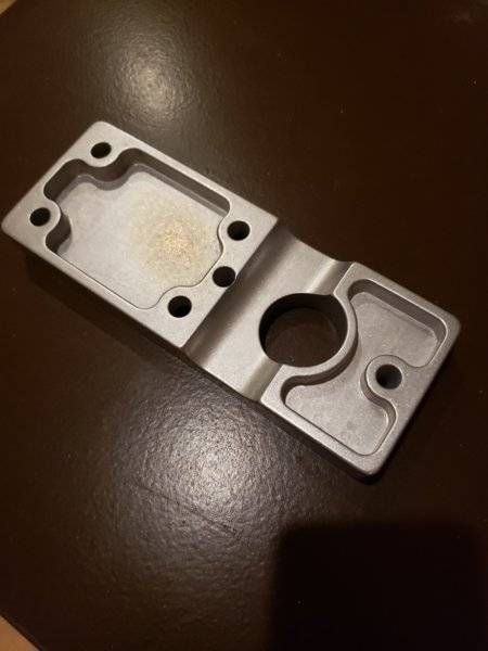

I got this from Mike Roth at MR2 performance. 765-483-9371

Not my car, but I think this is the MR2 adapter
