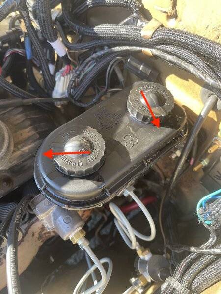

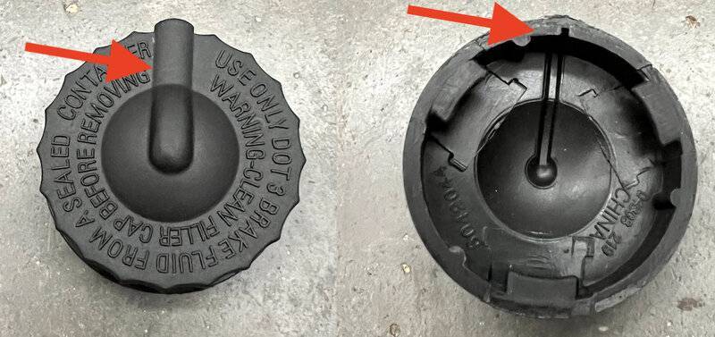

These are the vents, you don't want them pointing forward
Here's how NOT to face the caps... (vents/arrows should be pointing at the firewall).

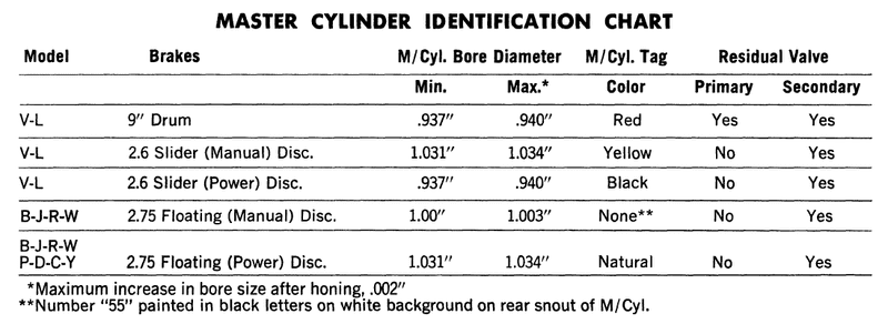

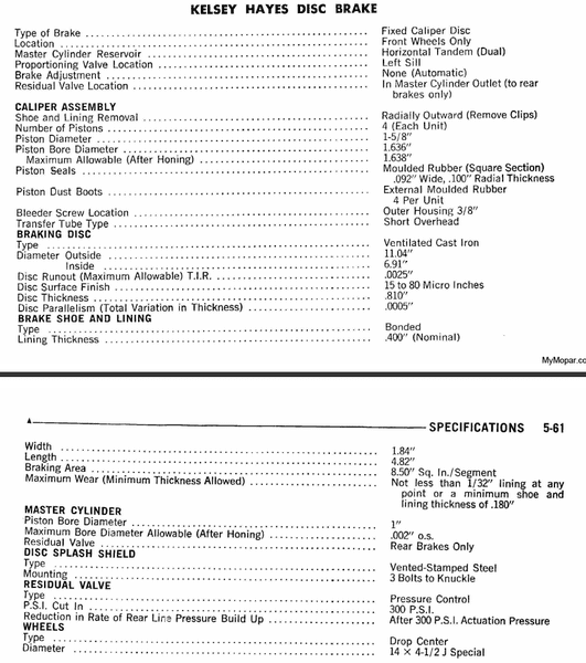

A-bodies are actually backward when it comes to manual and power disk master cylinder bore sizing. That's because the power booster linkage for the A-body changes the pedal ratio. So the power disk cars actually got a smaller bore master cylinder than the manual disk cars.
This is from the '73 manual, for drums and the later single piston calipers with the manual/power differences listed. A-bodies (V&L) have a larger MC bore for manual and smaller for power, while the B/J/R/W follow the usual pattern of having a smaller bore MC for manual brakes and a larger one for power brakes.
From the '70 manual for the KH disks, only one bore size listed
