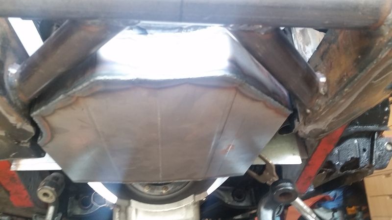

My motor is set really low to keep the crank center line low so it's not a wheelie machine plus my car is really low. I just made a custom flat pan, holds 6 quarts give or take a little.
tks junior, guess it didn't take much to convince me to go to the short pan. The fenderwell headers really dictated the stock engine location which caused so many issues. "Man only truly learns from negative experiences"
Nice work on the pan and crossmember. Good looking welds man
