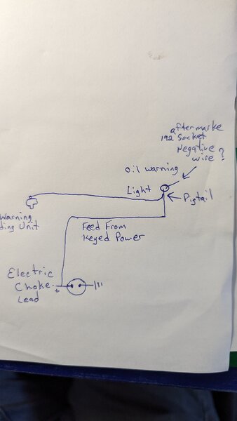

Ok just to visualize, I'll pull power from choke lead to warning bulb then send it back to the sending unit via pigtail. It'll be grounded through the block at no bring surface. I bought the 192 socket off Amazon it has a negative wire so I just need to cut that wire off then?

You're feeding power THROUGH the light, so no- you don't cut any pigtails off.
Power goes into the light via the pos. wire (red) and exits the light via the black wire and goes to the sending unit.

Ok!!
Thank goodness I asked. Would have been a drag to have to pull it apart again. :thumbsup:
