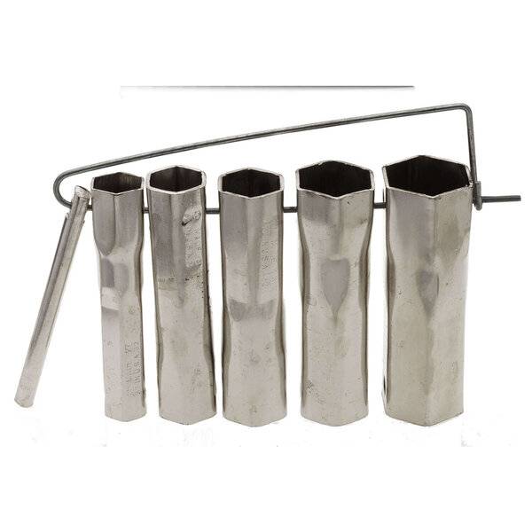

That low doller sensor was a pain for me to tighten with a crows foot.

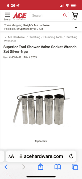

I was in the hardware store yesterday and saw a set shower socket valve wrenches that would work. I did not get them but I might. I am adding 3 inch extension pipes later this week
