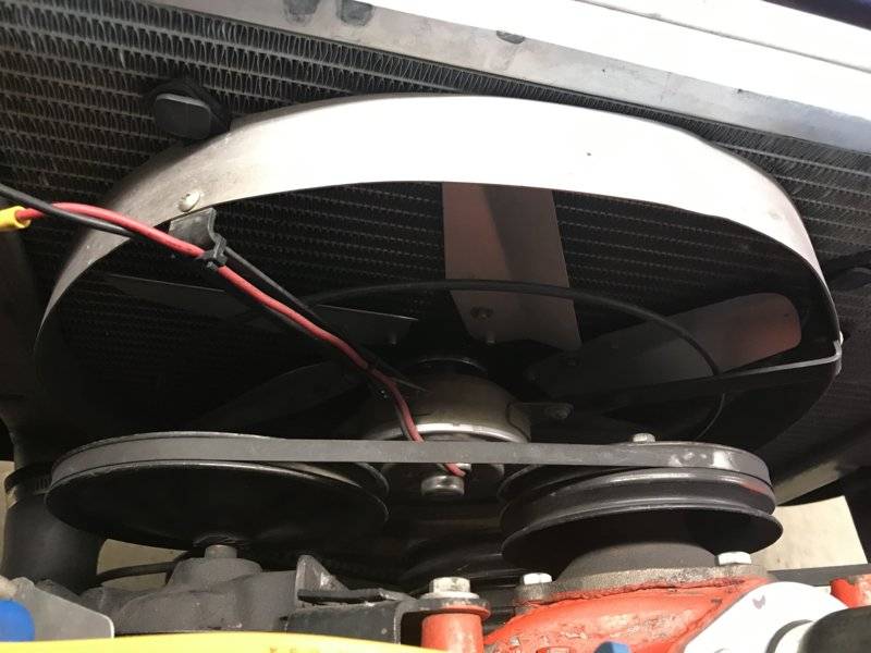

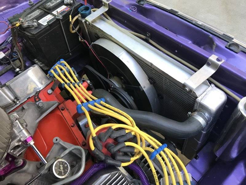

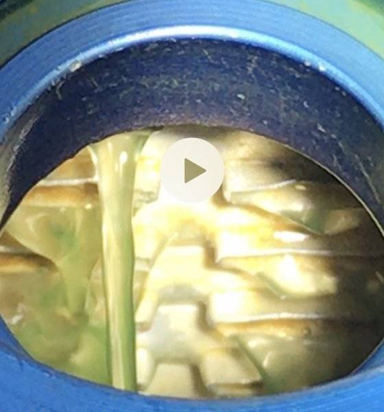

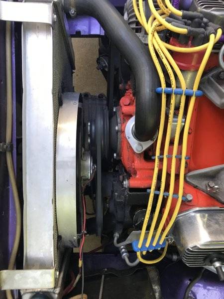

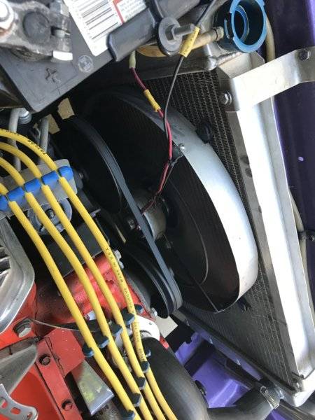

Ok Here is the fan, shroud and radiator set up. The fan is 17 inches and it supposed to be at 2950 CFM. The radiator is 19.5” x 27”. I remove some of the coolant so you could see the flow that begins at about 180°. The videos are at about 190°
It won’t let me post the video because it says it’s too large but here is a picture of the coolant flow at 190°
Your shroud is blocking off more of the radiator than it includes. You need a shroud that includes the full rectangle of the core. Also, if you have a pusher on the front, unless it is completely out of line with the inside fan, they are somewhat cancelling some of each other's air movement. 2950 is nowhere near the needed amount for a high performance engine. The absolute smallest I would use would be 3300 and I would rather have 4000 or higher. You get that core seeing more air flow and I just bet you fix your problem.
That sure doesn't look like a lot of flow. Tough to tell from a still picture. I would agree about asking the pulley diameters on the crank and water pump. Maybe even get that radiator flowed to assure it's working properly. Between water and air flow, SOMETHING is wrong. I would work on a better shroud that included all of the core, more fan and increase the water flow "somehow". It looks like you have a few things fighting against you.
