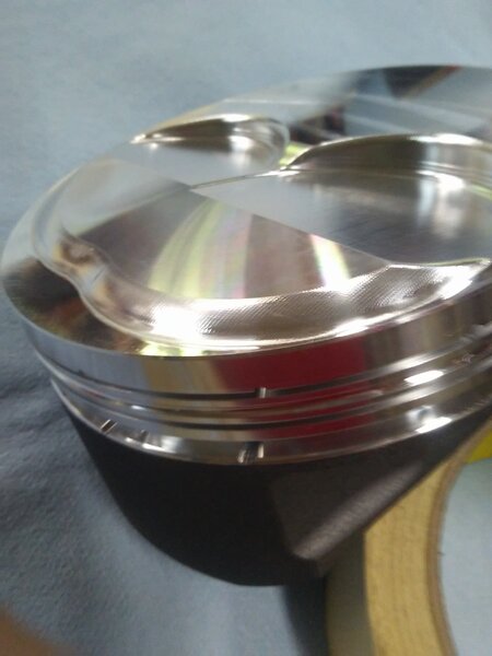

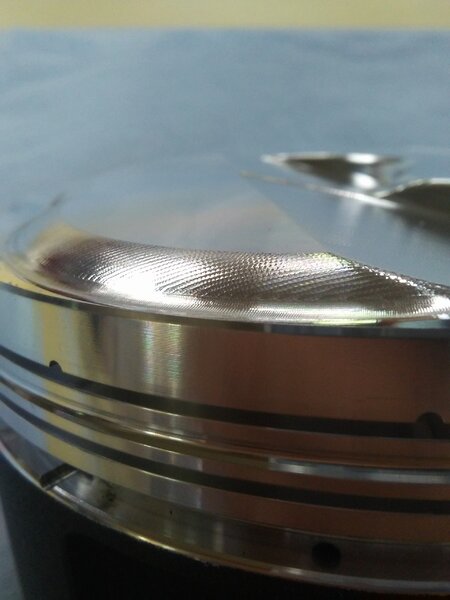

Those pistons are a work of art. nice, I wouldn't want to get any carbon on them. lol
It looks like you put together some premium parts for a killer build.
Thank you. We certainly try to put the best we can afford into our program, especially the engines.
