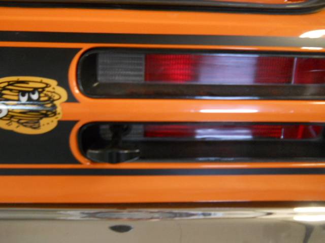

I put a kill switch on the battery. I drilled a hole on the reverse light so not to mess up the car with a hole through the body. The wheel house had a tab on it with a hole. It was a perfect spot for the ground wire
