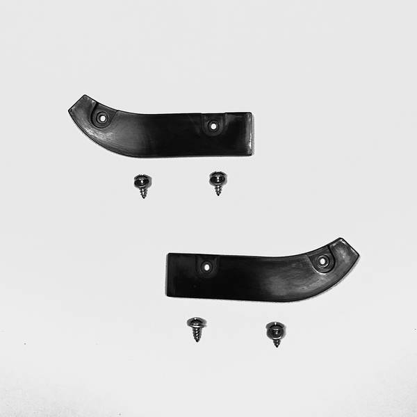

The rubber bumper fill protectors screw to the under side of the tail light area, not to the bumper. The S shaped brackets help support the ends of the front and rear bumpers. All the same, 63 through 65.
Mopar A Body 63-65 Barracuda Valiant Rear Bumper to Body Protector Filler

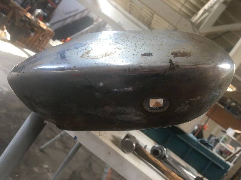

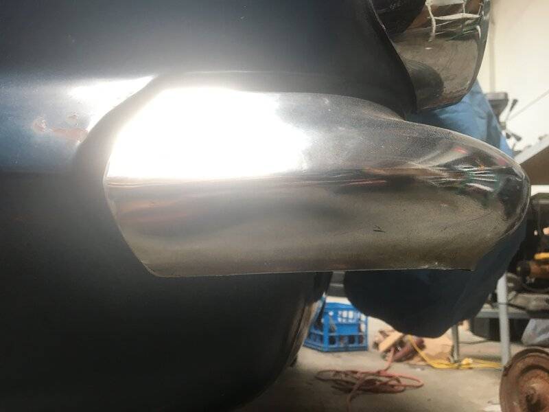

I’m thinking the bumper is for a different car. Theres a slight peak in the center, the brackets and the license plate relief are different. I’ll post pics- maybe someone can ID it.

The 67-69 Barracudas have the small curved brackets as end supports for the front AND rear bumpers (which are the same, by the way).
The 63-65 Valiants and 64-65 Baracudas only have the small suport brackets up front. In back is a bumper cushion that bolts to the rear quarter, behind the bumper outer ends. There is no attachment to the bumper for this cushion. And no hole for a bumper bolt on the outer end of the bumper, as shown on the left side of post #3.
The bumper on the right in your post #3 looks like a 67-9 bumper to me.
Part # on the bumper brackets corresponds to 67-69 Barracuda. Will be posting it for sale.
