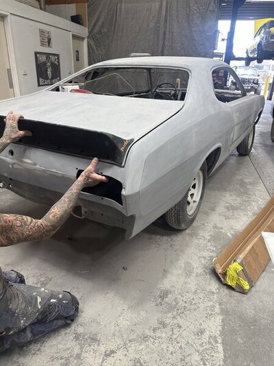

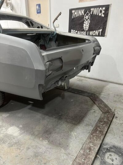

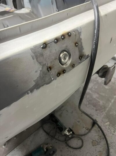

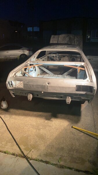

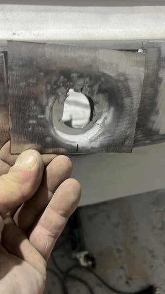

Got the rear tail panel looking spotty dog, someone had made the key hole look like a cats arse not sure what kind of debortury had taken place...... glory hole perhaps.
Also looked like someone let a shot gun off inside the boot as lot of small dents outwards etc. All tapped out and welded a new boot lock section back in.

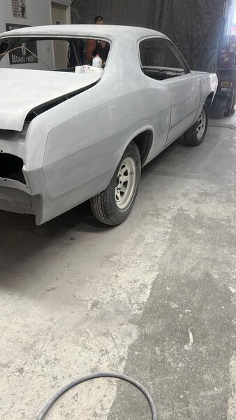

Rear of car all done ready for paint, boot lid just needs the smallest smear of shmoo and waiting on my duck tail spoiler. The tail light bezels fit like a **** in a sock as well. Maybe a 1mm gap at most around them in spots that the gasket will easily fill up. I have a 73 rear bar that i will fit up just need brackets. Then its off to the chromers for new chrome along with the front bar. I am leaning more and more towards flat grey as the colour of the car with black bonnet and side stripes

Thanks!!! Panel work all but finished just going back over every panel looking for any small dents or anything missed. As found the right sider quarter panel line wasnt as sharp as would like. Currently cutting the lips on the rear wheel arches back to stop any rubbing.
Next stripping entire floor back to bare metal, then undercoat, weld chassis stiffening in and install the rear end.

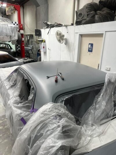

Finished the roof over the weekend, had a dent towards front of roof most likely due to being a vynil roof car and factory not caring. Started the process of stripping the underside of the car, it has a pretty poorly done sound deadener, not sure thats factory as missing in many place.

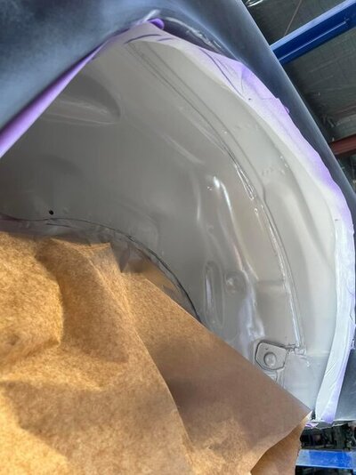

We are also trimming the fold around the wheel arches at the rear as they about an inch wide so to stop scrubbing will cut back and re weld.

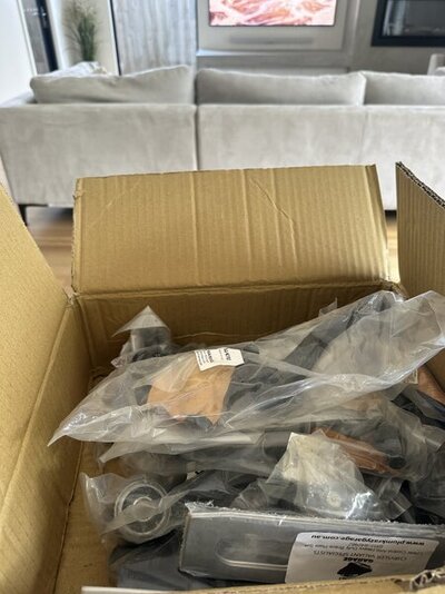

Rebuild front suspension with a rebuild kit with Polygraphite kit by Performance suspension

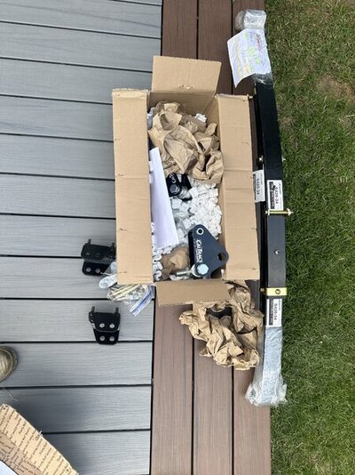

So my, Calvert mono leafs rolled up with an inch drop, including my calvert caltracs. Got the Dr diff half inch off set as well as the stiffening plates that go behind the mount.
Also have a full rebuild kit for the front end including stiffeners for the lower arms, decided against Qa1 arms for now.

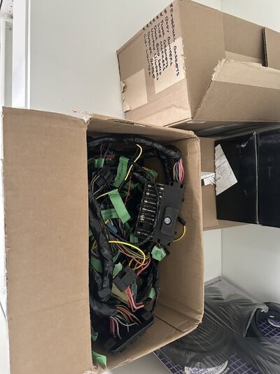

When pulling the car apart i discovered that the car has a seat belt lock out. So i got a guy who restores factory looms to modify a 72 loom to fit my 74. Comes with the front two looms i will remake my own rear loom.
I will also unpick the glass fuse box and put a more modern fuse box on it
He also made the side markers my indicators as well at the front i have deleted the rears.
The best thing it all clearly labeled

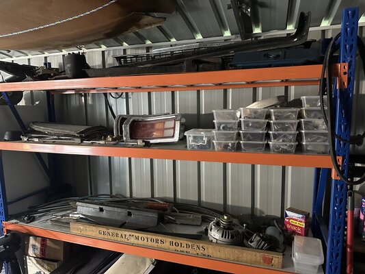

O and this is my shed haha, pretty much the whole car stripped into a few shelves other than bumpers, seats and dash. All bolts etc all labeled and in their own containers depending on part of body they are from. For example one plastic container for left door, then all the bolts bagged in individual bags and labeled etc

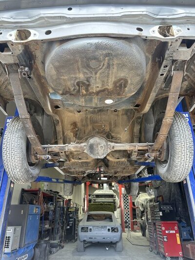

So we have commenced work to underside of car. Removed the petrol tank and will remove all brake and fuel lines. Tank actually in pretty good condition, looks to have a fair bit of rusty orange crap stuck to the walls inside. If can get a tank cheap will maybe replace. The straps are like new. No rust or anything found that raises any red flags. Excited to get it back to my shop and chassis stifen athen will raptor line entire under side of the car. Has anyone raptor lined under side of car thoughts?
Some one looks to have tried to sound deaden the underside with a poorly applied deadener.

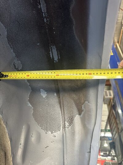

So we have trimmed the large lips of the quarters all the way back to where the tub begins and re welded to get as much rubber room as possible. I have a 275 on a 8.5 inch rim so should fit nicely and a 3.5inch back set so diff shortened to get it perfect. You can see below the lip flares out again to original size so got maybe nearly half an inch off it
Then all bare metal removing all the old body deadener, neatly seam sealed and primed ready for Raptor liner. We have removed all fuel and brake lines to make the job easier as entire under side getting done as well to bare metal

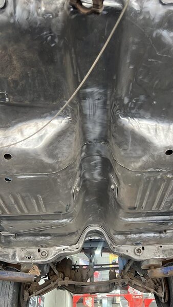

So the stripping of the floor pan has been a mission as some one has sprayed a sound deadener on very thickly and the wire wheels etc goo up quickly. Getting there, we will sand blast the hard to get bits once we get the bulk of it. Floor pan etc in crazy good condition, no big dents and the sound deadener wasnt hiding any sins

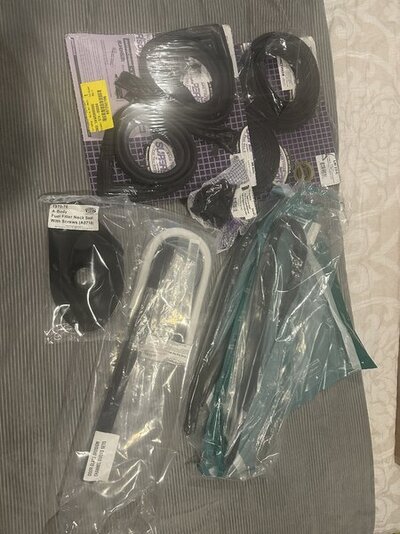

So more parts, have all the door rubbers, door end seals and the coupe glass rubbers. As well as the coupe window to side glass strip. The coupe kit is made by Precision rubber from detroit muscle where as the door rubbers are by Metro soft rubber i think. Hopefully all good fit still to get front and rear screen rubber
Whilst shopping at detroit muscle also picked up a new tank to filler neck rubber. Looking like everything going to be new or completly restored or custom.
Anyone used these rubbers any good?

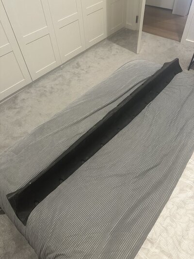

My rear duck tail also arrived looks like going to need a bit of work to make fit nice. But it should work, i think i may get someone else to do it as will take a lot of hours
Underbody looked like this before going into primer so very happy as in great condition. Nearly ready to screw stuff back on!!

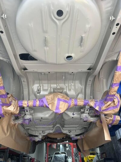

So under side all finished for now, all in epoxy primer. Now to weld in the torque boxes and frame connectors. So glad was nothing hiding under the sound deadening, the under body came up super clean.
Once we weld underneath we will raptor line the under side tinted to body colour. Still not sure on what colour to go with.

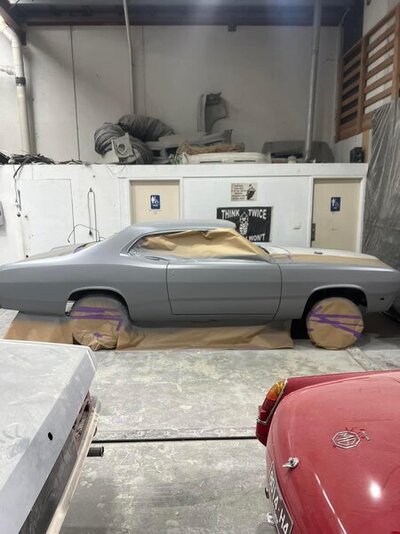

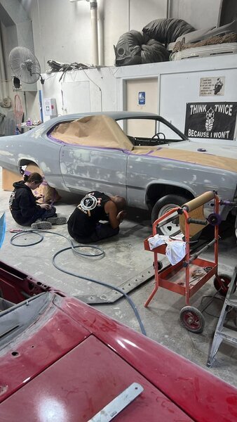

So i wasnt happy with some of the lines so played around with them more, had a couple of small dents that were missed on the passenger side. It was difficult as when doing the passenger side the quarter on the drivers side had not yet been replaced.
Once the drivers side was all done we realised the passenger side needed sharper lines. The front of quarter had, had a bad pull job at some point and the diagonal body line was too smooth.
I am not precious and i am not bragging it has no filler, however it only has a skim here and there. I am very happy with the results! Has come a long way from where it was. What you see is a completely rust free Duster thats had every inch to bare metal, acid washed and primed. Excited for the next stages.

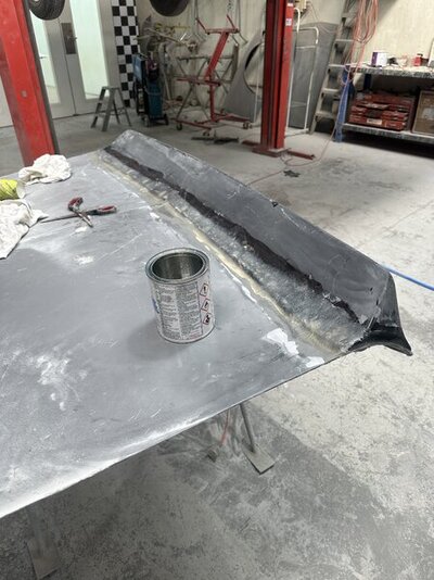

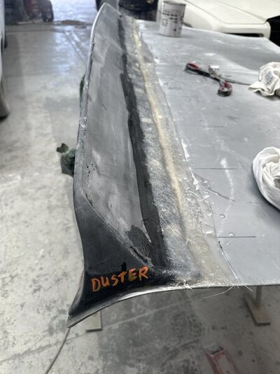

Started on the duck tail, obviously they need a lot of work as quite distorted and dont fit very well. So we decided playing around with the tail off the car would be too hard. As both front and back were no where near straight enough to match the boot lines.
So we took the tail to bare metal, laid fiber glass sheet down and screwed the tail down over that. Then glassed up the holes as didn't want it looking like i frankensteined it on with bolts.
By laying the sheet down we can build the front and back edge up, so we can straighten the endges on the car rather than as a seperate piece as less stuffing around. As i want to keep the edges so it dousnt look like its moulded to the boot but rather stuck on but a perfect fit.
As you can see from the pick we have built the fiberglass up as the tail didn't kiss the boot lid in many places
The top and back also have some bad casting issues so will need some love as has some serious highs and lows in it. However this can be fixed with filler.
Its a work in progress however this is going to transform the 74 *** end from a boring rear to a rear that matches the staunch look of the rest of the car
