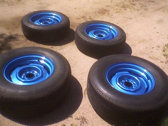

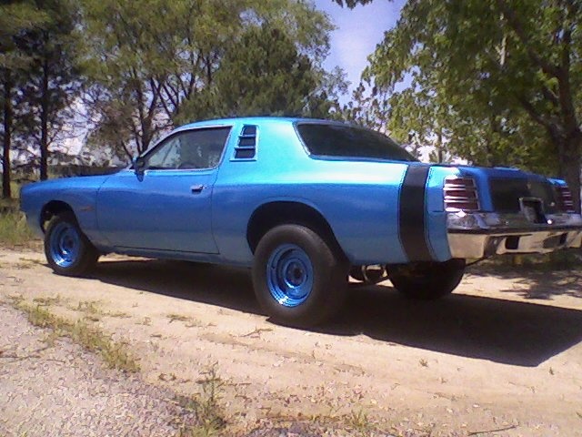

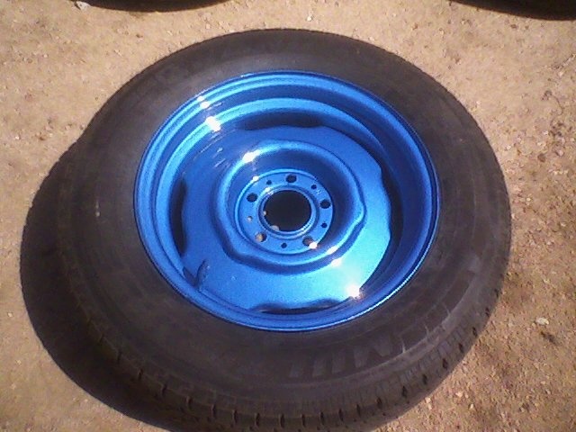

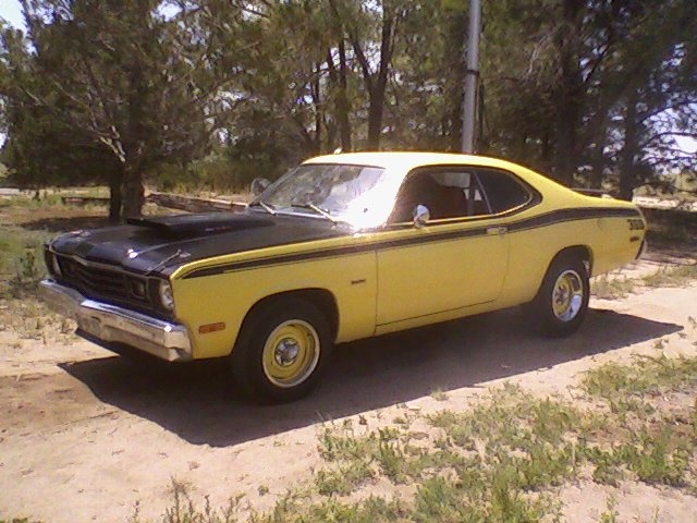

i have two sets , the blue ones are 15 x 7 lebaron wheels in the rear and 15 x 6 1/5 in the front. the yellow wheels are the older style 15 x 7 in the back and 14 x 5 1/2 in the front
pics arent very good

i only have 2 of the 15x7 lebaron steels. the tires on the blue pair are 235/70/15 and the tires on the yellow 15x7 are 225/70/15
What are the tires sizes on front? Thanks!
the fronts on the blue wheels are 195/65/15 and the yellow are 185/65/14.
i have centerlines on the charger now, so one of these days im going to paint the blue fronts yellow and stick them on the front of the duster lol..maybe
