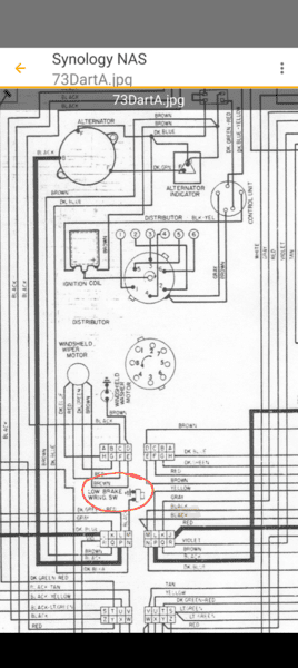

I will need to post some decent pictures when I get home. I have the manual for 1973 and it's in the wiring diagram as well. The previous owner labeled it, they had removed everything, as the parking brake light and the wiring matches what is in the manual. I posted some pictures last night in a post but it was in the wrong room and it was deleted.
73 wiring diagram confirms
Low brake switch goes to M
M goes to printed cir board 10 and the parking brake switch
10 goes to one side of the light bulb
The other side of the lightbulb gets power from a switched feed
Wiring diagram available from mymopar.com

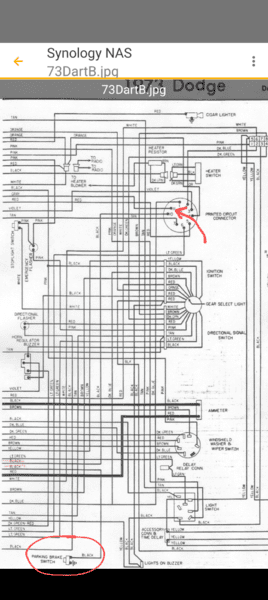

I will send pictures from my manual. The switch goes into a diode (matching what I physically have) then the other end of the diode has a black wire that goes into a splice that does to brake lamp and low brake fluid/brake failure warning indicator.
The diode that bd2595 refers to was only used on 73-75 abodies with manual transmissions.

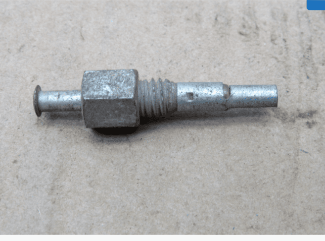

This is what the Parking brake switch should look like and has been used from 63-77 on basically all Chrysler cars
Is the terminal that plugs into the end of the switch

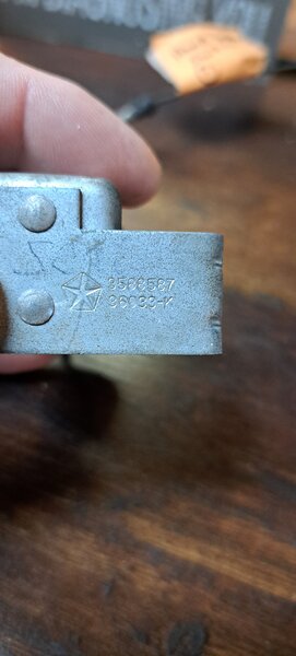

Here are the pictures. The black wire from the actual switch was attached (barely with one strand) to one side of the end of the diode. The other end of the diode had no wire, but you can see there was a wire on it at one time. I am going to try to reattach as I said and finding another would be great.
Where does B3 go, it looks like it prevents a back feed from B3 thru the bulb to the bulbs feed.
From your photos I don't see any reason why you could not cut the broken ends off and crimp new proper ends on.
