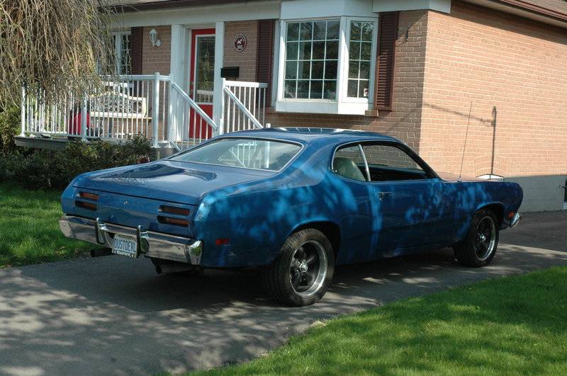

I am considering buying these 17in rims for my duster. I was hoping to see if anyone has a picture of these wheels on a duster or the ability to photoshop them on the car. I have attached a picture of my car for reference. Any help would be appreciated!

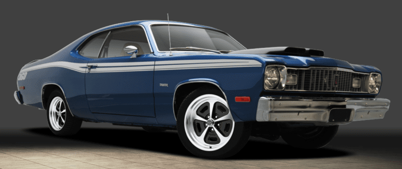

American Racing : Heritage: VN501
Well you can use the American Racing's little "preview on your vehicle" configurator thing to look at them on a Duster, although it's a later one

The problem with the VN501's is that they're only offered off the shelf in a 0 offset rim for a 17x7 or 17x8, which will limit your tire choices. They have a 17x9 in a +12, but even that's not enough to go as wide as you should be able to. With a 17x7 or 17x8 and 0 offset in the front you're probably stuck with a 225/50/17 at the most. If you go to the 17x9 +12 then you could do a 245/45/17, but that would probably be about it and that might look a little stretched. 255 would be pushing your luck for fender clearance up front and that definitely wouldn't work if your lower than stock. In the back a 17x8 with a 255 would be easy, but again you'd be pushing your luck for a 275 and quarter clearance, it would depend on your ride height. Stock height might work, any lower than that wouldn't.
Here's a set on a black Challenger, the 0 offset works much better on an E-body...

Here's a quick photo hack. I'd call it photoshopped but that would be giving me too much credit. :p Should be relatively close, they looks smaller than my 18's and bigger than 15's while keeping the tire size relatively close-ish...

Thanks for the work! I enjoy the 15in look as well as the more modern rim and tire. I have been wanting to have the more pro-touring look lately. What is the most efficient want to drop the car an inch or two?
I love the stance on your car. Those wheels look great! What is your suspension and wheel set up?
Thanks, wheels are coys 17x7 front and rear drilled on 4" BC. 225/45/17 Front 235/55/17 rear. Stock suspension, rear sat low already and I adjusted the torsion bars to bring the front down.
