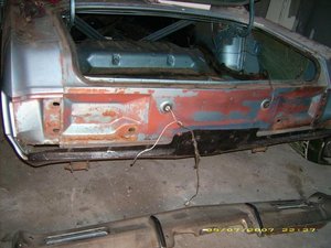

Mar 27, 2010 #3 wifehatesmycar Well-Known Member Joined Dec 2, 2006 Messages 81 Reaction score 1 Location Navarre,Florida This is a 70 Dart.
Mar 27, 2010 #4 S Super T Thisfieldistooshort Joined May 28, 2009 Messages 454 Reaction score 0 Location Aurora, IL Poop. Looks like we're cuttin' and fabbin'. Thanks!!!
Mar 29, 2010 #5 johnparts Slammed 1 Joined May 10, 2009 Messages 2,429 Reaction score 54 Location Lisle Illinois Eh I made it fit
