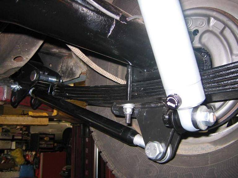

Looking for some pics of Cal-Tracs installed on cars with Stock springs in the stock location.....got any? Also does the front pivot go on the out side of the hanger or inside?
This is onehellofadart's picture.
Tony...the pivot goes on the outside of the spring hanger on the dtock set-up correct?
Thanks Tony....read through that a lot.....I think it does by the looks of that pic....the main reason is that I am going to run them with my poly bushing in the spring for a while....until I have the cash for the mono leaves....
Tony did you switch to the solid spring eye bushing? I'm thinking that with the stock Mopar Springs and in the stock location they go on the outside...but with the relocation kit that go inside......
I'm thinking there might not be enough room for the pivot with the stock hanger.....
onehellofadart said:
I do remember that the inside bolt head had to be ground down for clearance.
This leads me to believe they are mounted on the outside.
Again though I will have to check.
